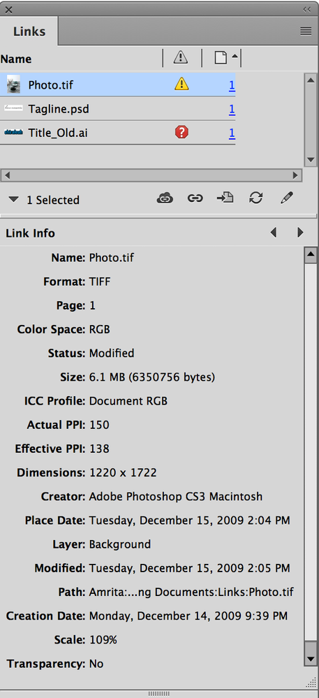

You can tell whether it's missing or modified by looking at the Links panel. Red stop sign means missing. Yellow triangle means modified:
