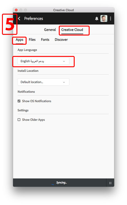

Option 1: Uninstall your InDesign, then change Language from Preferences to make it "English يدعم العربية"
Now, you can reinstall InDesign. This method will give you only one InDesign that is English with full Right-to-Left support for Middle Eastern languages.

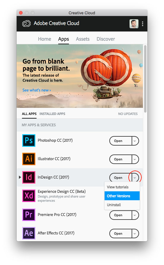

You don't need to remove existing InDesign copy, just add another copy that supports Arabic but it has to be different version. Here are the steps illustrated…
At the end, you will have one copy of InDesign CC2019 that supports Italian, and an older version that supports Arabic on the same machine.

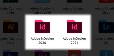

Let's say you already have the International English 2021version of InDesign installed on your machine. The other older version shouldn't be International English also, you rather need to change the language in Preferences to French for example then download the French 2020 version of InDesign.
By following the above, you will end up with two copies of InDesign…
French 2020
I'm on Mac and above does work for me and seen it work for others

Yes, you need to change the language to the one marked in red (English يدعم العربية) before installing an older InDesign copy.
