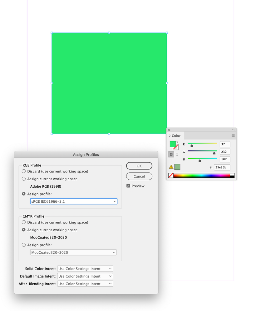

Hi @sascha26841088hap6 , The Adobe print applications are color managed—the display of an RGB value depends on the document‘s RGB color profile assignment. The application showing the color picker in your screen capture is probably not color managed and is displaying the RGB value using your OS’s Monitor profile.
Here you can see I have created a fill that matches your #25e86b RGB hex value, and I have the InDesign document’s RGB profile set to sRGB:
If I change the RGB profile assignment to a different profile, the RGB color appearance changes, but its values are the same:
I could assign my system’s monitor profile and get a different appearance. Assigning your Monitor profile (Edit>Assign Profiles...) would probably match the color appearance you are seeing in the application with no color management capabilities.
