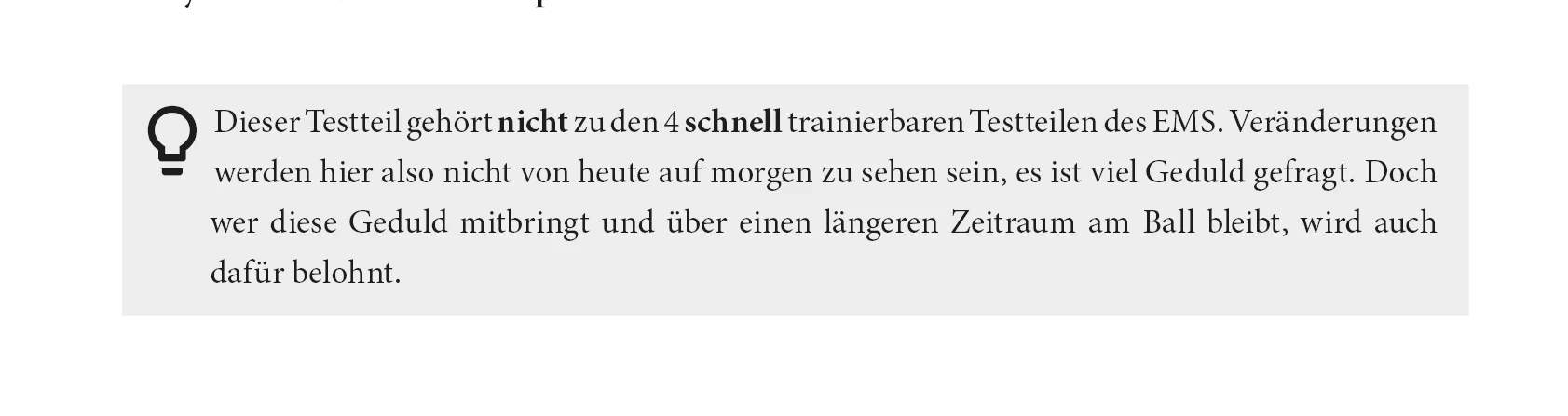

This is how it should look:

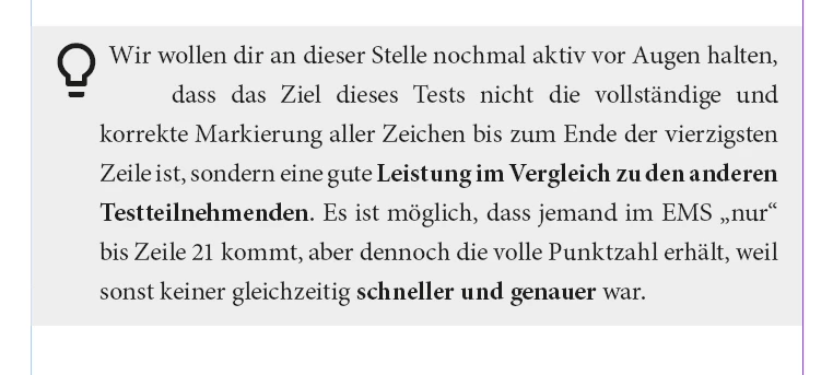

This is how it looks in the other document:
Does anyone have an idea how to take out the gap in the second line? Changing the distance on the left and taking back the first row doesn't solve the problem.

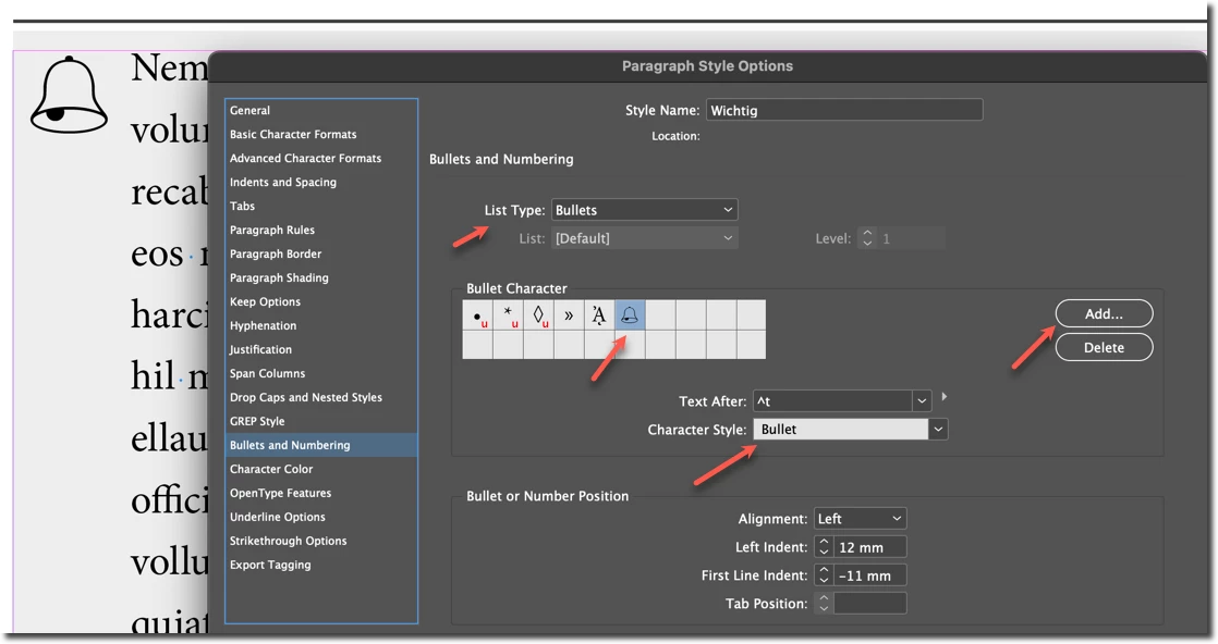

Hi @Mirjam Pi:
This issue as I see it is that you are trying to combine a drop cap with a hanging indent and InDesign is pushing that second line to the right to make way for the drop cap. Both features work well on their own, but not together. (Not clear why it would work in one file, and not the other though.)
If you increase the number of lines the bulb drops, the pattern continues. How about setting this up as bullet with a character style to change the font, increase the size, and push it down with a baseline shift?
~Barb

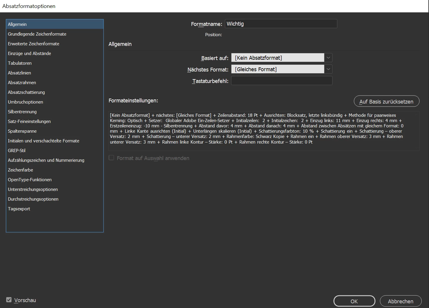

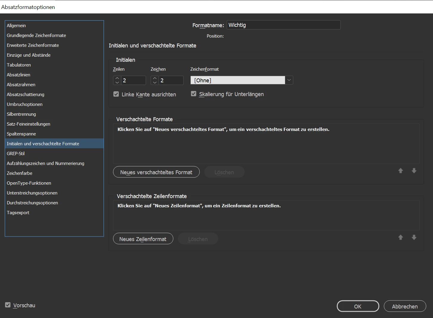

My Indesign Version is v18.0, It looks on my Windows Computer (Win 11 Pro) and on my Macboook (Ventura) the Same.
Attached a sample Indesign File.
And here some Sceenshots.
