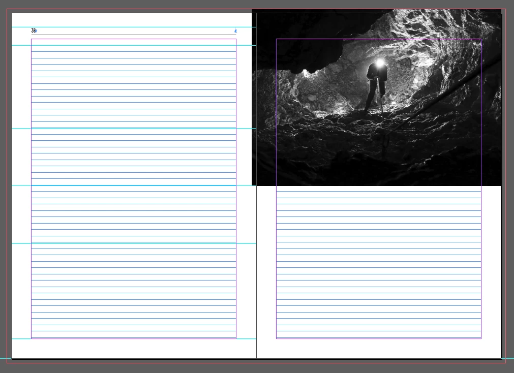

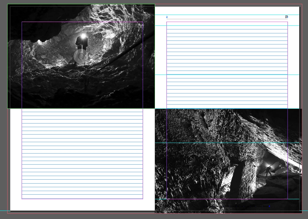

I have a document like in (pic.1), where the images are placed on a “Background” layer and extend to the page bleed.
When I insert a single page before these, the result is that the image ends up out of place and has to be manually adjusted (pic.2).
What I’d like is a way to make sure the image always stays centered (or even aligned to the bleed would be a suitable option) regardless of whether the page is on the left or right.

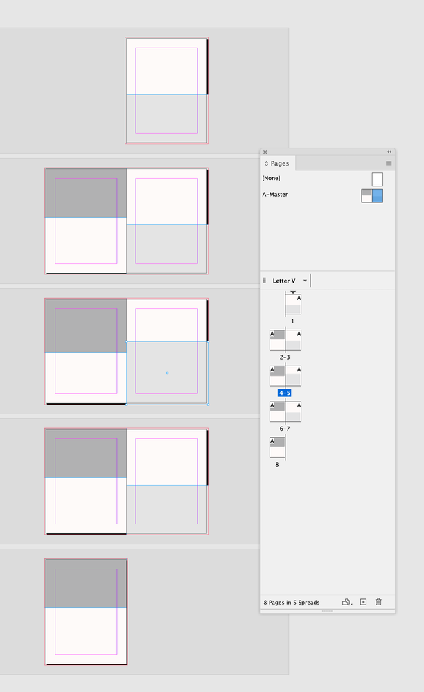

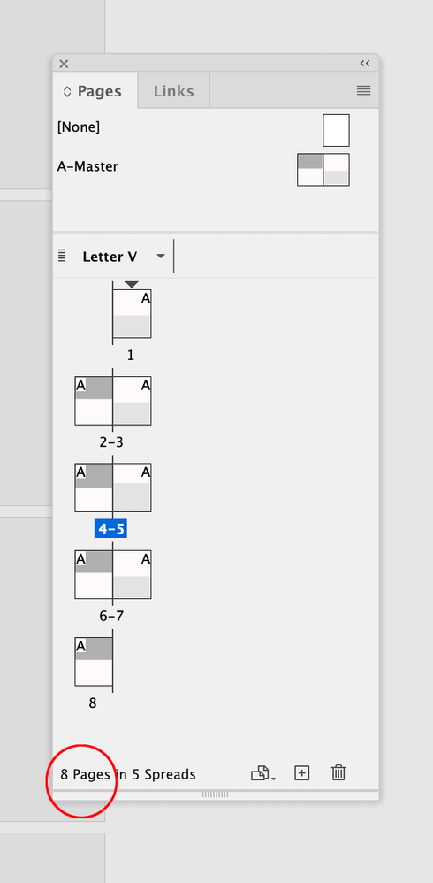

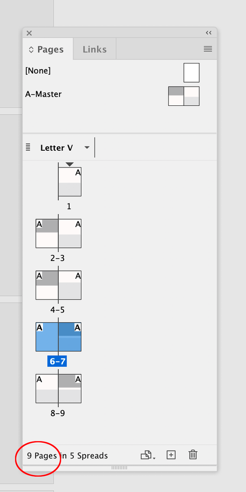

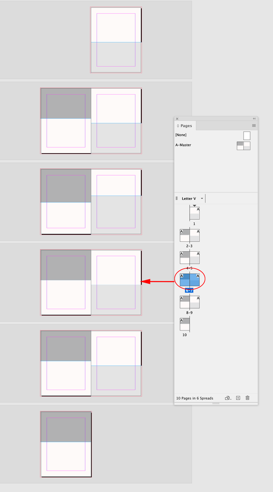

Hi @DavideB838 , I assume this is for print? One approach might be to add spreads rather than single pages. If you add a single page to a document containing 8 pages, and now have 9 pages where is the page that would have to back up to the new page? You can’t bind a document with an odd number of pages:
Adding a spread

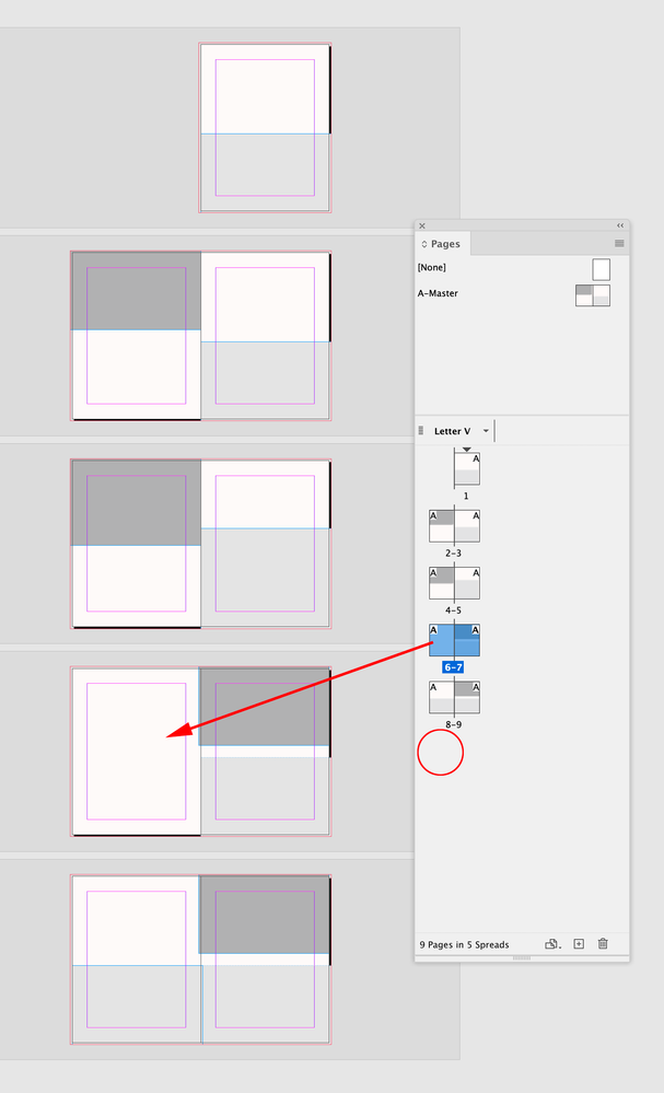

I don’t think I can manage the pages that way. I’m laying out a magazine that contains various articles of different lengths
Before you add the single page, is the page count showing in the Pages panel odd or even? If I add a single page to this document I’ll get an odd page count—another page has to be added before this can be printed. Where would it be added?

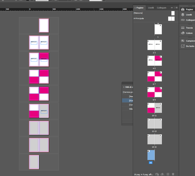

As I was saying, since this is a magazine, I receive a series of articles that are not in order and vary in length. Sometimes they start on an even page and sometimes on an odd one. Once they are arranged in order, what was previously on the right-hand page might end up on the left. To reach an even number of pages, single-page ads will be inserted here and there.
For example, this was my starting situation with a 6-page article.
But then I was asked to insert a 3-page one before it, and onther one after it. And I find myself in this situation:
So now all the pink images/boxes have shifted, and I have to reposition them manually.
Of course, I can handle all this manually — that’s what I’m doing at the moment — but I was wondering if there’s a way to manage these possible shifts more automatically when inserting pages.
