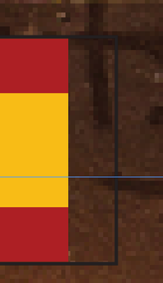

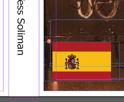

I've attached a test document (please be careful as there a lot of 'loose' elements) for example the flags have a border on them but not constrained to the flags - not sure if it's intentional
Here's my take on your settings
You have hardcover selected -so you need EXTRA bleed for this.
This is because the paper itself is wrapped around the hardcover and glued to the inside of the board.
So your bleed should be the WRAP setting
Where it says 'hinge' - this is a safe type area - no text should be included here or anything of value - artwork/backtrounds' are fine.
This is where the board is scored to allow the book cover to open and close without damaging it (checkout any hardcover book)
Set your front page inside margin to be 0.394
Set the back cover outside margins to be 0.394
When I do this -  you see your Spanish flag is on the crease
You can see your artwork is outside the 'Margins'
For this it will need to be either inside the margins
Or go full bleed

But please check your artwork carefully - you've a loose frame around your flags and not sure if you meant that.
Please check everything - I was only applying the KDP settings and showing an example in my test file.

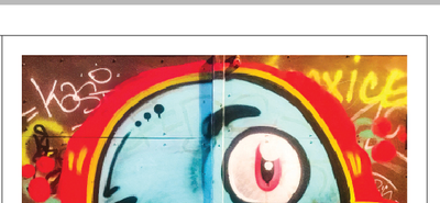

Community Beginner ,
May 26, 2023 May 26, 2023
Hi Mate8
It worked just a little tweaking .
This is how it looks
No problem - glad I could help.
Are you sure you're happy with the flag borders? I changed them to fit - not sure what you had was intentional?
And Graffiti on the front cover doesn't look 'visually' centered. Even if it's 'centered' it looks like it could be better centered by nudging it slightly to the right.
Now you have all your settings correct you can complete the artwork.
Just don't put any important artwork/text outside the margins.
Only background colours/artwork for outside the margins
Icons/Flags/Text/important images should remain inside the margins.
