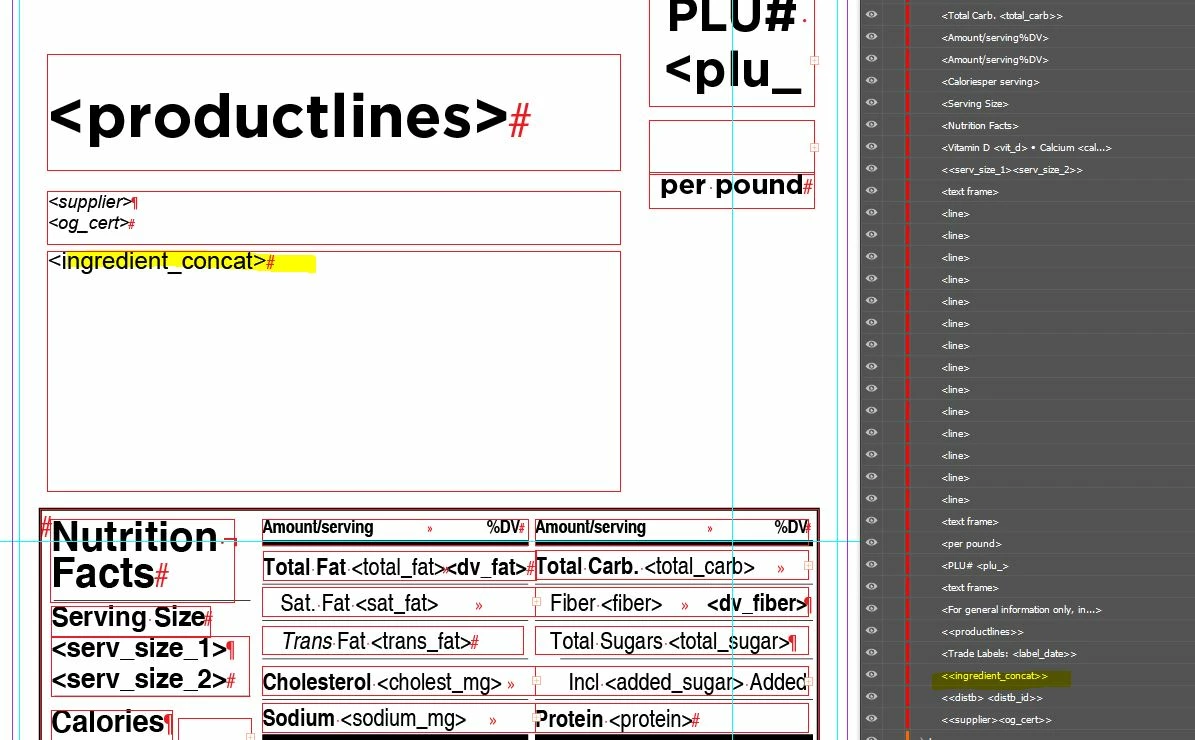

I have an InDesign script that processes txt data to create labels using different templates. For my "stone_acres" case, I need to dynamically resize the ingredients text frame width based on which background template is used:
  • When currData["template"] == "STNAC_OG": ingredients text frame should be 2.6268 inches wide (189 points)
  • When currData["template"] == "STNAC_CV": ingredients text frame should be 3.5403 inches wide (254 points)
The text frame contains ingredient information and needs to wrap around logos placed from a "Logos" layer. The script processes the template AFTER text replacement has occurred, so the original placeholder <ingredient_concat> has been replaced with actual ingredient text starting with "Ingredients:".
Issues: They are not sizing correctly- text widths appear too large and run off the page.
Current Code:

Do you have your Indesign set to points? I have my Indesign set to inches and use inches in my scripts. What size do they come out to? You can check the size of what came out to what you were expecting and figure out what unit type it is using.
New Here ,
Aug 22, 2025 Aug 22, 2025
Hi John- it's set to inches in the property box.
Is this what you mean?
Ty!
Engaged ,
In the Preferences/Units & Increments. I would try switching over to points real quick and see if that fixes the problem. Faster than trying to adjust the script.
You can set the measurement unit used by the script, with something like the following
app.scriptPreferences.measurementUnit = MeasurementUnits.POINTS
-Manan
