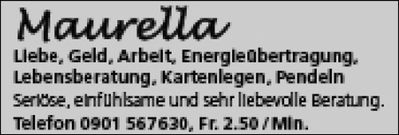

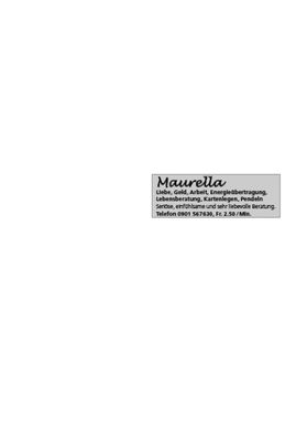

Sadly the size of the Layer is to big. The whole site gets exportet to a jpg, but not only the LAyer it self. The size should be as the Layer size:
How it i s with this script:
How it should be:

So I figured, your Code would be the things I needed. Do you know how to scale the exportet jpg's, so their heigth and width are correct?
Like I mentioned in the Reply above, the jpg's are exported in the wrong size. Haven't found out, how to export with the right height and size.

The JPEG export exports the entire page or a selection. An InDesign Layer doesn’t have a dimension—it can contain page items that do, which would be pageItem[i].geometricBounds in JS.
@Mike Bro ’s script is exporting the entire page with the targeted layer visible, so the export would be the page as the canvas, with the visible Layer’s pageitems positioned on the canvas.
If you are trying to export a page item as a JPEG it could be done but I think it would be more complex
