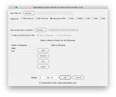

I have a paid script on my colecandoo.com website that data merges to single records in several image formats:
 Would this be of use?
