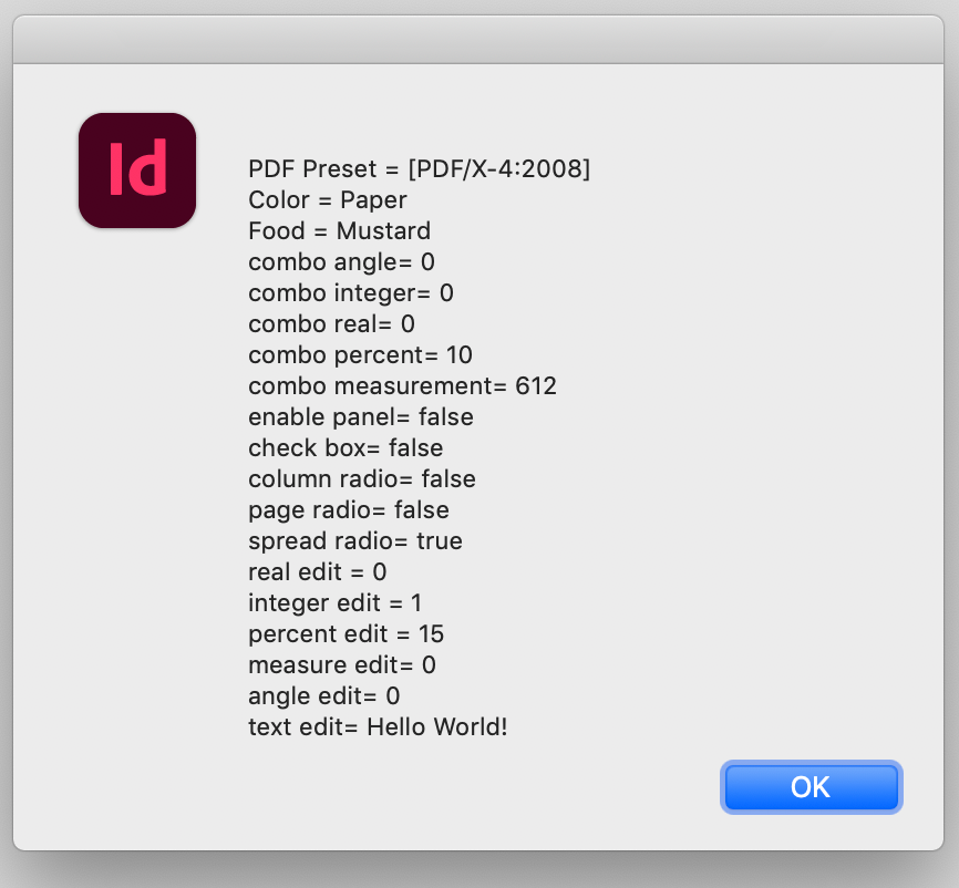

The output values returned to the main script
