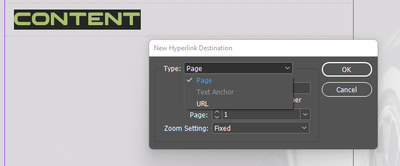

  3. In the New Hyperlink Destination dialog box, select Text Anchor from the Type menu, and enter a name for the anchor (Appendix). Click OK.hyperlink-2.png

I'm probably missing something obvious but I can't get past step 3.
Text anchor doesn't seem to be a clickable option?
