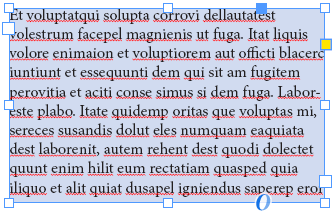

    I've run into this issue before, and there is a workaround.
    1. Draw a rectangular frame with the Type tool. I've filled it with placeholder text.
    2. Give it a fill color.
    3. Give the frame a thick stroke. Change the Join to the rounded join, and change the Align Stroke to Outside. You'll want the stroke color to match the fill color of the frame, but I used a contrasting color so that you could see it better.
