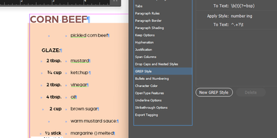

May 19, 2025 May 19, 2025
File>Export and choose IDML
then attache the file here
Participant ,
May 20, 2025 May 20, 2025
Works for me - even though you have incorrect code 
\b(t)(?=bsp)
should be
\b(t)(?=bsp\b)
But 100% is working my end

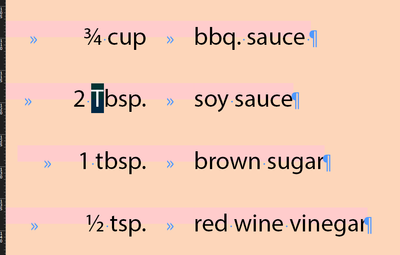

So your document has it typed as an uppercase T
It is working - you've typed a capital T I can see it in the Story Editor
when I change it to a lowercase t it still displays correctly
And if mess up the pattern it resorts back to lowercase
Are you expecting tsp as well as tbsp to change?

LEGEND ,
@hendy_5450
First problem - your "number ing" GREP style was overriding everything else - I made it green:
So I've changed the order - and then removed it entirely - didn't help.
With shading OFF and a simplified version of the "cap first" - yellow for a better visualisation:
And I've switched to Minion Pro.
LEGEND ,
@hendy_5450
Soomething is wrong with your "t" letters in the "tbsp"?
Once I manually enter "t":
It get's converted to a "T" - highlighted - and on your original file:
I don't have your font - but "t" get converted to "T" instantly.
