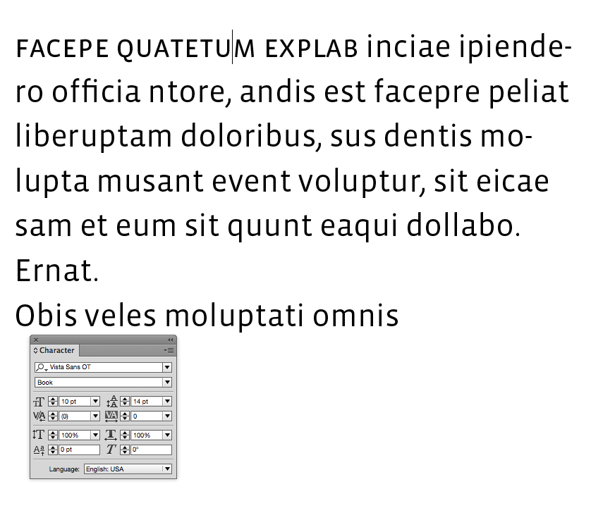

Changing to another full OT font works:—VistaSans OT

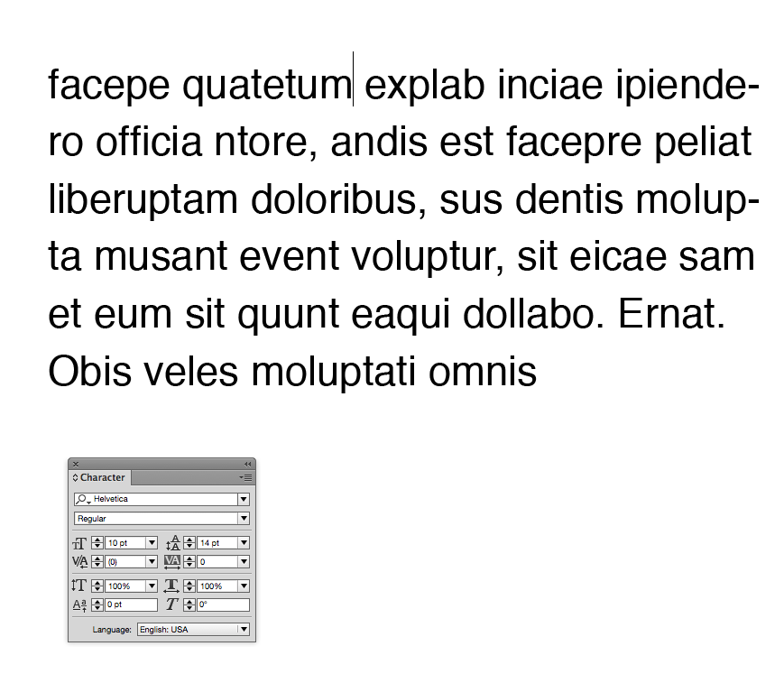

But T1 Helvetica doesn't

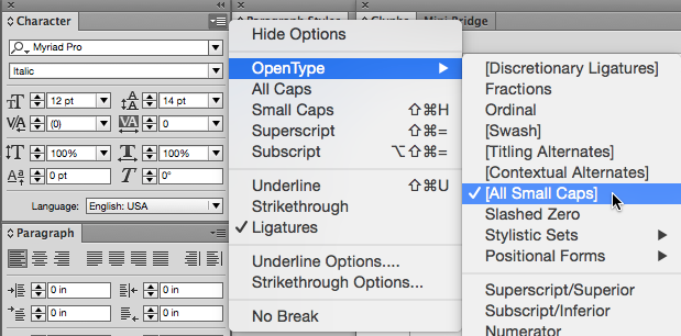

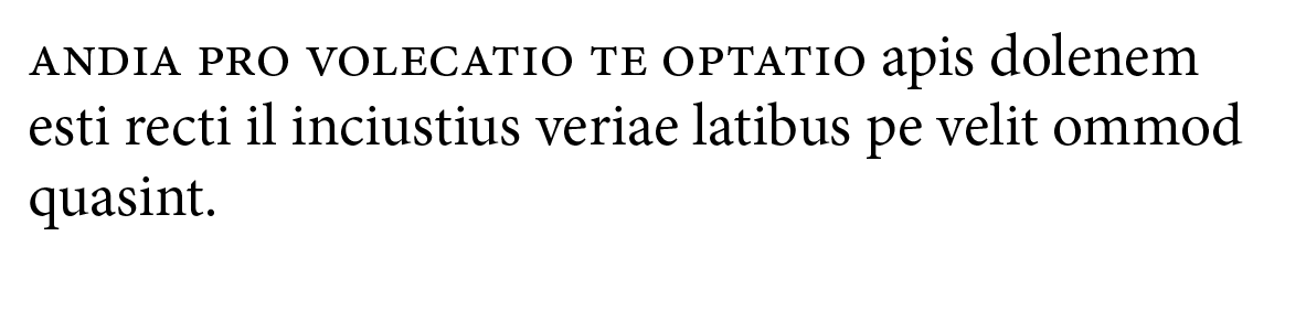

I don't think that is an InDesign bug. The open type All Small Caps depends on the font having the small cap glyphs included in the font. If you use a font with a full glyph set in both its italic and roman there won't be a problem. So, MinionPro works:
Same text set as italic uses Minion's italic small caps

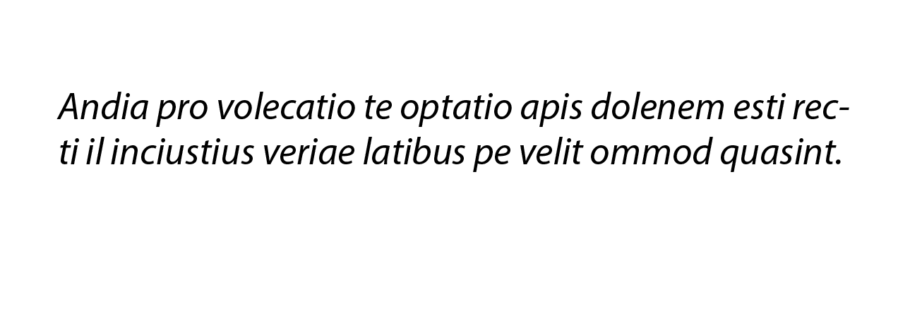

But the Myriad otf that ships with ID doesn't have small cap glyphs, so the small caps are lost on the switch:
If All Small Caps is bracketed the glyphs are not available
