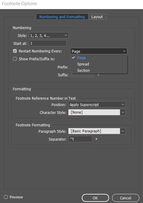

In your Type>Footnote Options
Try changing the settings

Correct. You can have footnotes restart numbering at every section (or page, or spread), but the start number can be set only once. So if you set the start number to 12, and restart numbering every section, then every section starts numbering at 12.

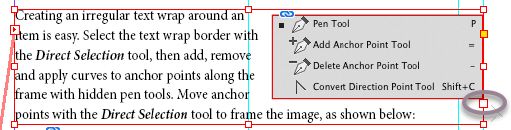

  • Now navigate to the end of Chapter 1 and get your Arrow/Selection tool. You're only doing this because you want to confirm you're at the absolute end of the Article/Chapter 1 text thread. Click on the last text frame for Chapter 1 and make sure it has a blank exit point like the example circled below. If it doesn't, extend the bottom of the text frame until you see a blank exit point.

  • Get your Arrow/Selection tool and click on the small + sign exit point for Article/Chapter 1. This will pick up all the following formatted text for Chapter 2 with what InDesign inelegantly calls its Place Gun, but now it's an extension of the text thread for Article/Chapter 1. as shown below:
