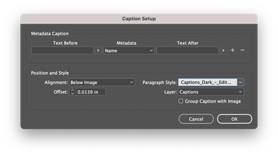

Sure! All I'm trying to do is edit "Object > Captions > Captions Setup" from:
To:
Basically I'm trying to change Paragraph Style and Layer to the preferences showin in the current active document. Is it possible?
Peter Kahrel
July 14, 2023
Probably. You'd have to delve into the object model. Take an object-model viewer (e.g. https://www.indesignjs.de/extendscriptAPI/indesign-latest/#about.html) and look for 'caption'. See which properties are available to you.
