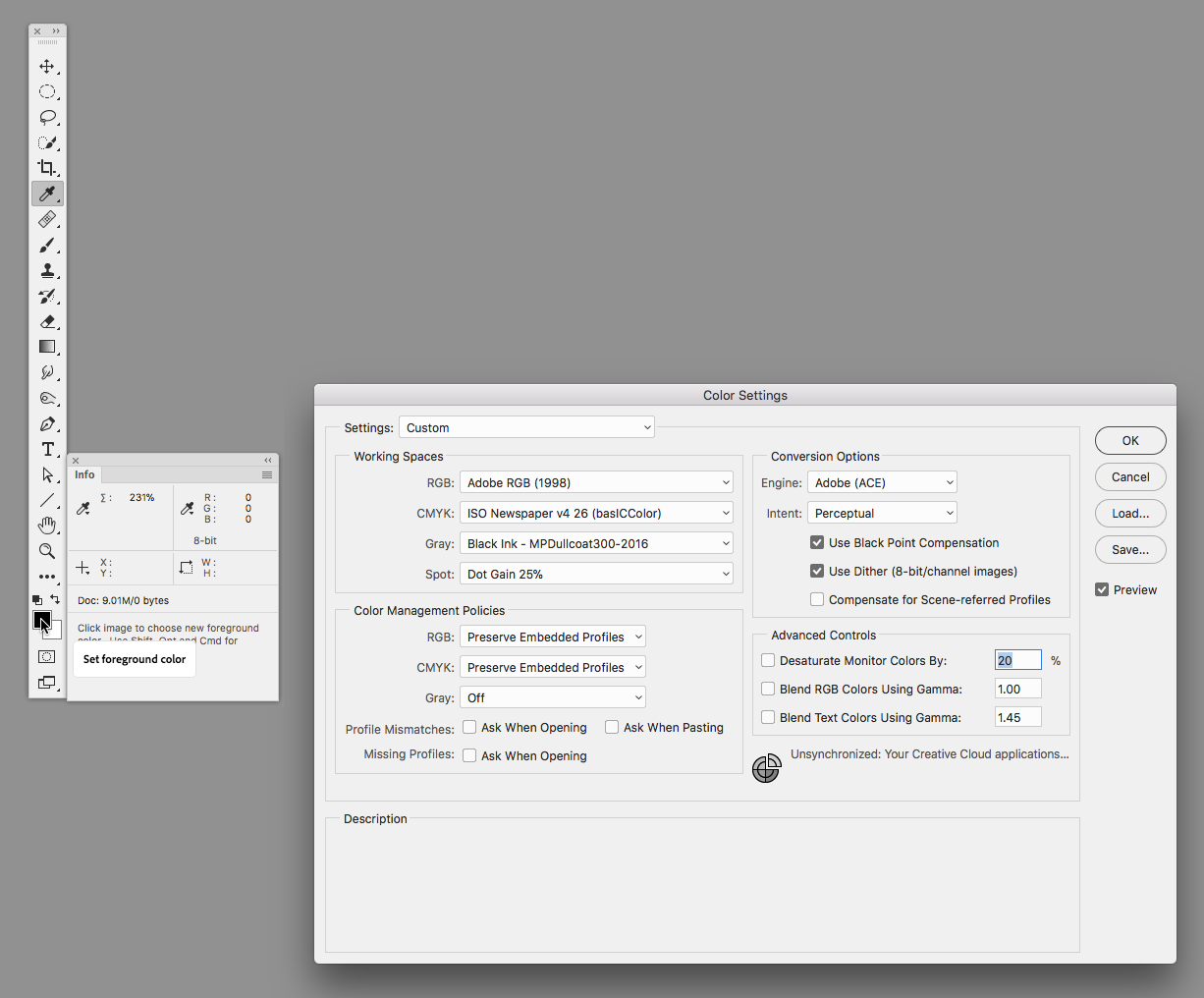

For most profiles the Intent setting you chose for the conversion will have some affect on the actual max total ink conversion. The Info panel will show the total ink for the foreground color when you sample it— 0|0|0 RGB here:
If you place RGB files in the InDesign layout and convert on export, the Color Settings' Intent is used unless you override an image's Intent via Object>Image Color Settings...

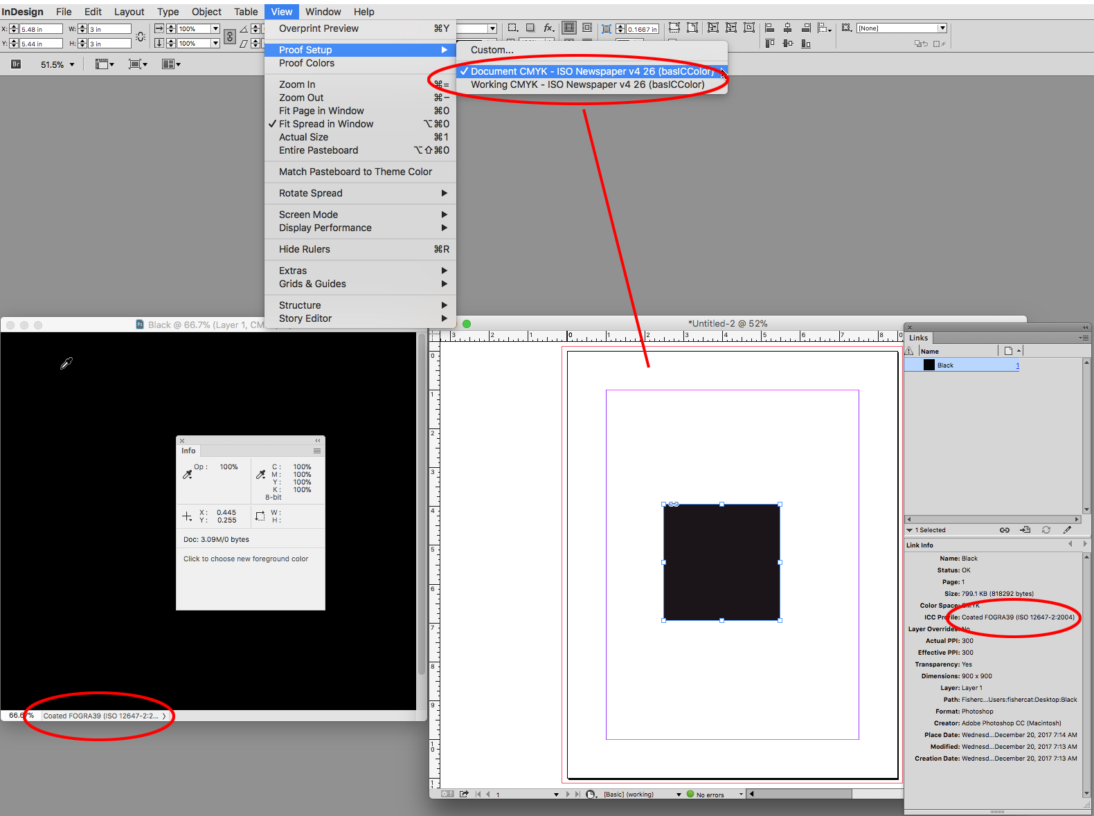

Dec 20, 2017 Dec 20, 2017
I performed a test by creating a simple PS file with a white background and a shape layer with 400% colour fill (cmyk Fogra)
If you really have no choice and are forced to place Fogra images, you have to make sure the Fogra profile is embedded with the image, and ID honors that profile in order to get a conversion on export.
So when you save the black test make sure you check include profile. Also, when you create the InDesign file, make sure the Color Settings CMYK Color Management Policy is set to Preserve Embedded. If you choose either Off or Preserve Numbers (Ignore Linked Profiles) then ID will ignore any embedded profiles and you will not be able to force the conversion to the newsprint on export.

Thanks Rob, that certainly appears to work.
So you effectively have to tell InDesign what each images' colour profile is, not what you want it to be.
I thought it would be a logical thing to have all the images converted to the same profile and then imported to InDesign so that you have a level playing field. I guess I am asking Indesign to double convert the image profile?

What ink limit are you looking for? The 200% you noted in your first post is lower than any profile's ink limit I've seen even with newsprint. Converting random CMYK images into the newsprint profile might not tell you what the real ink limit is because the source pixels might not approach absolute black—SWOP Coated 0|0|0|100 is a lighter value black point than 4-color 75|68|67|90. The rich black value would convert to a higher total ink.
Also your Color Settings' or Convert to Profile Conversion Intent will have a significant effect with some profiles. Converting 0|0|0 RGB to ISOnewspaper26v4 I get 217% with Relative Colormetric, and 231% with Perceptual.

ISOnewspaper26v4 limit is advertised as 230% (I get 231 using Perceptual), so you shouldn't be getting 240+ even with a down sample.

Do you have Use Black Point Compensation checked?
If you are manually converting via Photoshop's Convert to Profile... you can check it there. If you are forcing conversions when you export the page layout from InDesign, the Color Settings BPC checkbox will have an affect. In most cases you want Use Black Point Compensation checked to minimize shadow fill in. Relative Colorimetric with BPC checked usually works best if you are trying to preserve the source color appearance.

Yep, BPC is checked and Relative Colorimetric is selected in InDesign's colour settings.

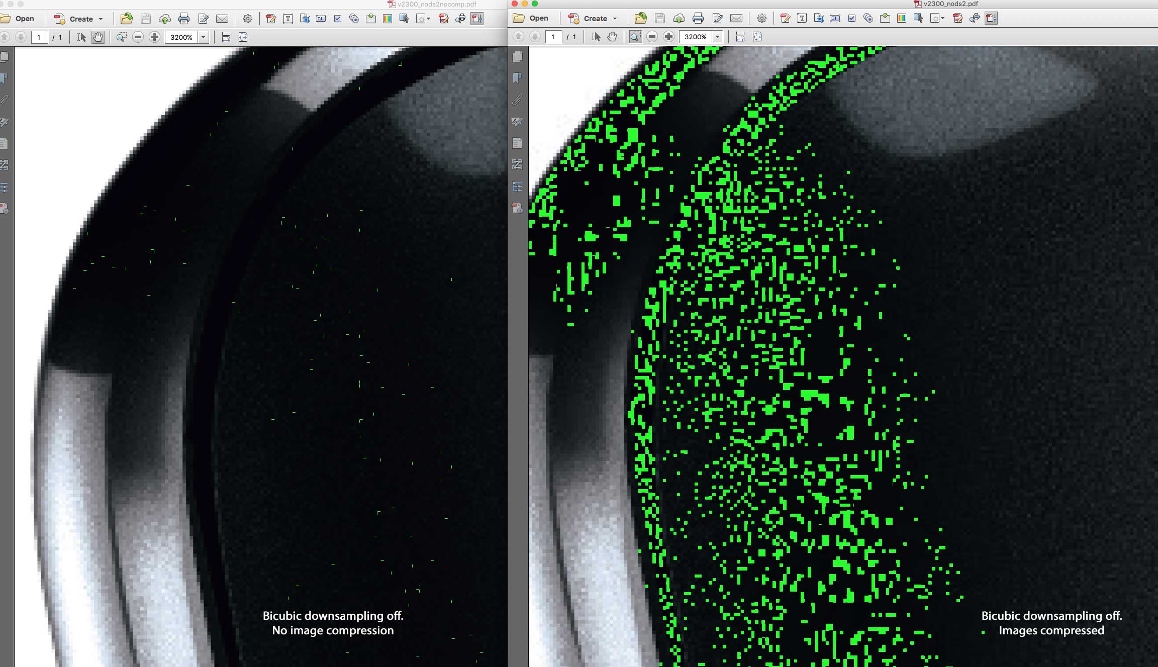

So, despite the amazing help I have been given here I performed some more test using Pass 4 Press settings (300 limit) and I am back to square 1.
Despite using the exact same workflow that worked for the newspaper files, I am still having issues with ink limits.
Here is the site that contains profiles, instructions and settings:
PPA : Pass4press
I am back to having ink limit issues even when turning off bicubic downsampling. I have also tried turning compression off completely, which helped, but didn't completely limit the ink coverage (ignoring the fact that supplying files with uncompressed images is not practical due to file size.
Interestingly, when looking at the coverage warnings in Acrobat for the uncompressed pdf, the highlighted areas appear to be between the pixels. This is starting to make me doubt the accuracy of Acrobat.

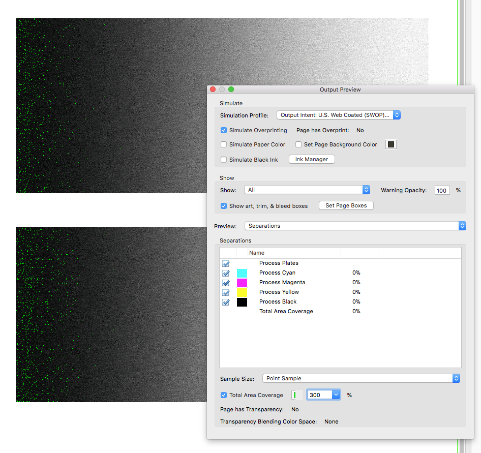

This has come up before—any jpeg compression will change some pixel colors and the percentages in resulting compression artifacts can increase. It looks like there are some compression artifacts in your left image? If you convert to CMYK and save as JPEG you might get the same affect.
Also, in Acrobat DC if I set the ink limit to 300% it will flag 300% pixels. Here my separation has 300% pixels (SWOP allows 300%). The export is with ZIP compression:

Also if you are making conversions using Photoshop's Convert to Profile..., it looks like checking Use Dither can push the limit.
Are the PDF's getting rejected in preflight? I don't think of total ink as that precise—does 302% create a drying problem while 300% doesn't?
