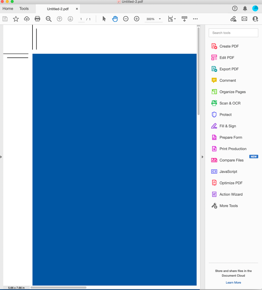

I don't know if you want me to start a new string, but I am having, what I think is the same problem. There is a bleed and I mark the crop and use document settings (or even set them manually) and make sure to use a PDF/S preset and The final pdf doesn't show the bleed, it stops before the bleed. I've attached it to show you. This is quite frustrating. I need to send it to the printer today.

Hi @deborahd68113104 , Can you show a capture of your Export Marks and Bleeds tab?
