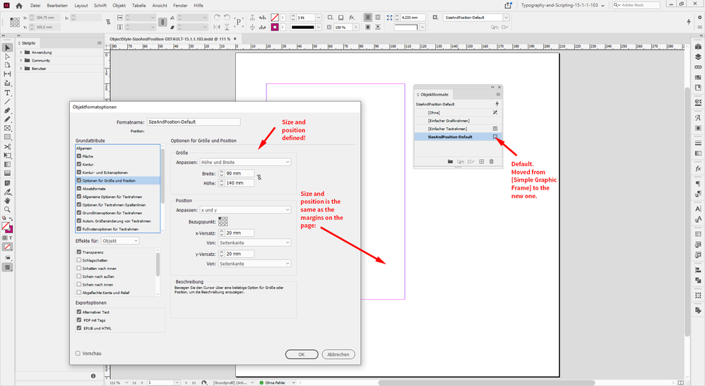

that would happen if you did an object style that would dictate the size and position of a graphic frame.
Plus, and that's important, that object style is made the default style. So look into your Object Styles panel and see if a custom object style is the default one. Properties Size and Position. Or if you changed the default object style for graphic frames with properties Size and Position.
This is a link to a document where I made an object style like that the default:
https://www.dropbox.com/s/59e4aiblhfut9sp/ObjectStyle-SizeAndPosition-DEFAULT-15.1.1.103.indd?dl=1
How is this document done? See below from my German InDesign.
A new default object style is defined in the Object Styles panel:
Size and Position restrict all new drawn items, graphic lines etc.pp. to the area of the margins.
This is no bug. It's a feature.
Uwe Laubender
( ACP )
