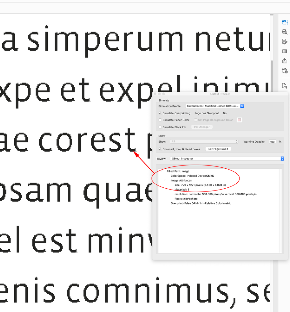

Hi @perrybrus , have you inspected the text in AcrobatPro to check if it has been rasterized or converted to outlines? If there is transparency on the spread and you flatten on Export (e.g., PDF/X-1a), it is possible to force text to rasterize or convert to outlines via the chosen Flattener preset.
Here’s a flattened X-1a PDF top vs. X-4 bottom:
PDF/X-4:
If the text hasn’t been rasterized or converted to outlines, the problem might be with Acrobat’s anti-aliasing preference settings—Preferences>Page Display
