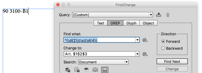

please share the screen shot of your document..
Engaged ,
Oct 20, 2016 Oct 20, 2016
the last two lines are different. I try to make a replacement for each eventuallity (with and without a space after the second digit)
Guide ,
Are using those in script or in indesign itself?
For indesign means..like below
for script means we need to add two slashes...
^(\\d{2})(\\s)(\\d{4})
