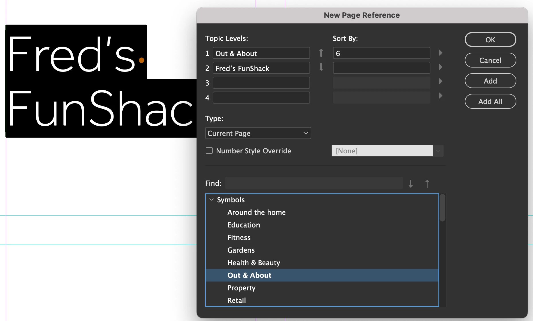

Hi all,
I'm writing yet another script (I keep thinking up new ways to avoid work)...to speed up the process of creating new page references for an index using an existing list of Topics (a list of Symbols(?)).
Usually, I'd select the text, e.g. Fred's FunShack, go to Index > New Page Reference... click the down arrow to move Fred's FunShack onto topic level 2, click the > arrow next to Symbols and double-click the Topic. Then click OK.
I've made a drop-down list (based on stuff gleaned from the web) that uses the existing Topics (again, 'Symbols'),  but as always I'm struggling and going around in circles (slowly learning though). I can't seem to pass the drop-down list selection into the next bit of the script to fill out topic line 1.
Here's what I've managed to cobble together:

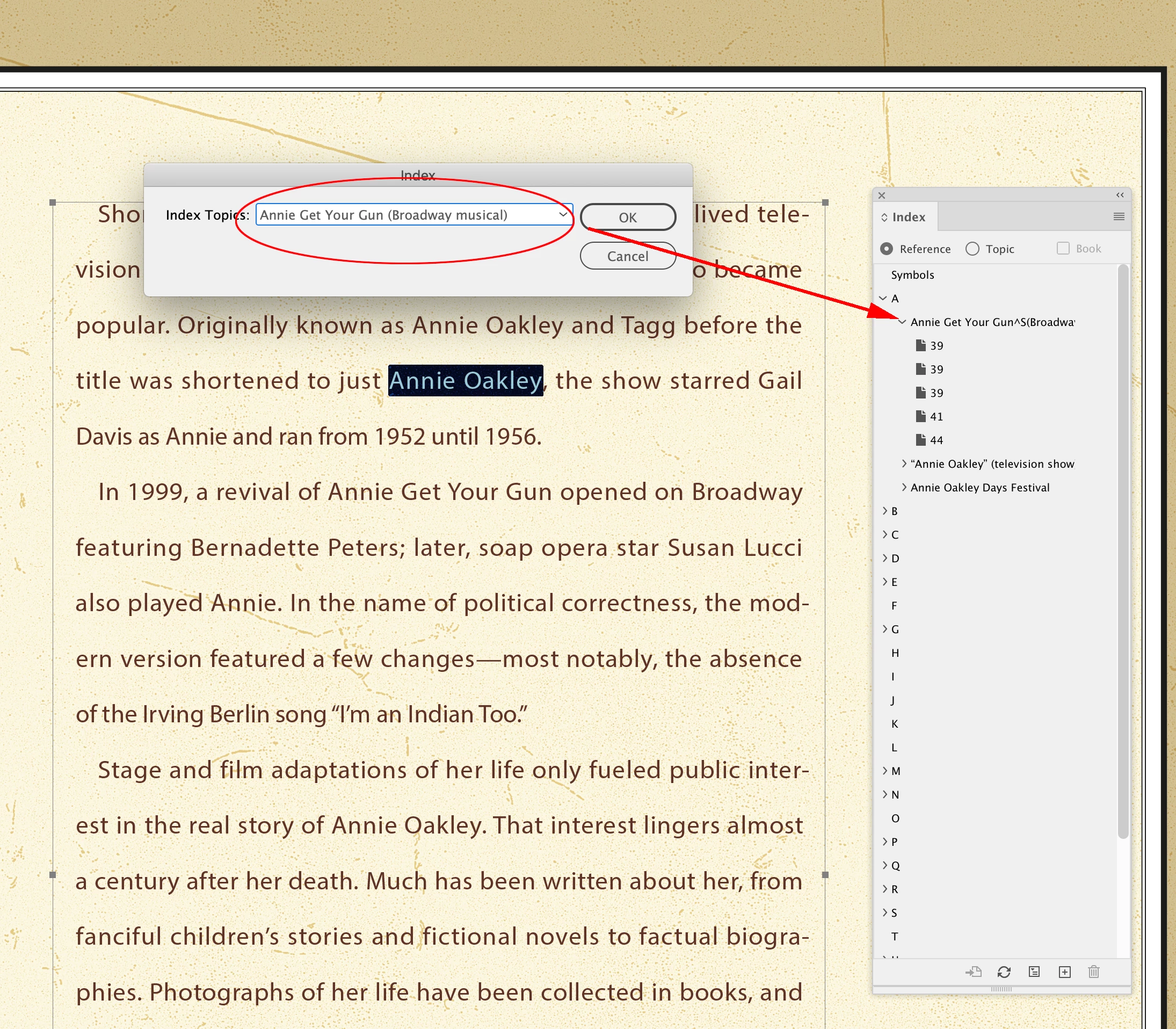

rob day
May 14, 2022
Hi @JustyR , Does this work for you?
if (app.activeDocument.indexes.length > 0) {
	makeDialog();
} else {
    alert("No Indexes")
var myTopics;
function makeDialog(){
    var theDialog = app.dialogs.add({name:"Index", canCancel:true});
    with(theDialog){
        with(dialogColumns.add()){
                    staticTexts.add({staticLabel:"Index Topics:"});
                    //Collection
                    myTopics = dropdowns.add({stringList:getCollection(app.activeDocument.indexes[0].topics), selectedIndex:0, minWidth:80});
        if(theDialog.show() == true){
            myTopics = app.activeDocument.indexes[0].topics[myTopics.selectedIndex];
            main();
            theDialog.destroy();
function main(){
    alert("\rChosen Topic: " + myTopics.name);
    return
* Returns a list of item names for the dropdown from the provided collection.
* @ return array of names
function getCollection(o){
    return o.everyItem().name

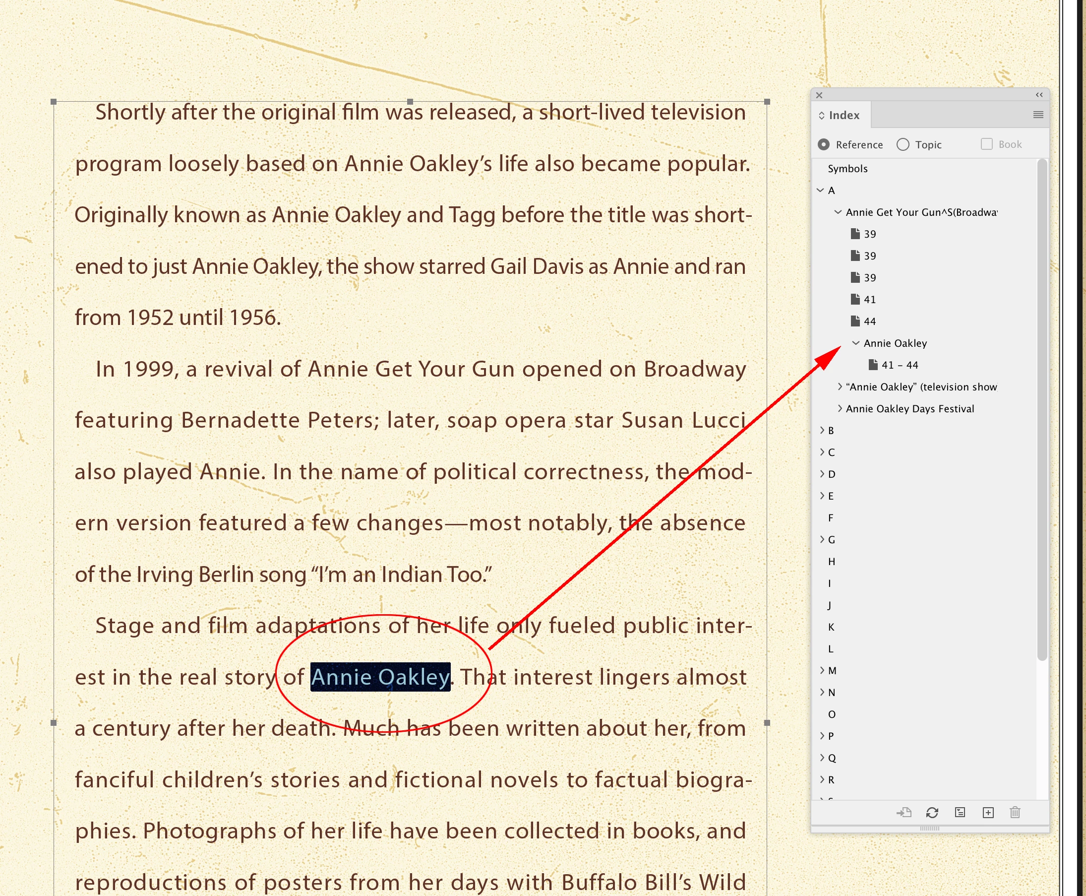

JustyRAuthor
May 15, 2022
Somehow I managed to get it to enter the chosen topic into the top level (see the two extra lines in the main function. I can't work out how to take the currently selected text (Fred's FunShack) and add it to the second level.
Any ideas?
	makeDialog();
} else {
    alert("No Indexes")
var myTopics;
    with(theDialog){
                    //Collection
            main();
function main(){
//adds menu selection to top level of index
	var currSelection = app.selection[0];
	myTopics.pageReferences.add(currSelection,PageReferenceType.TO_END_OF_STORY);
//need more code to add text selection to second level of index
    return
