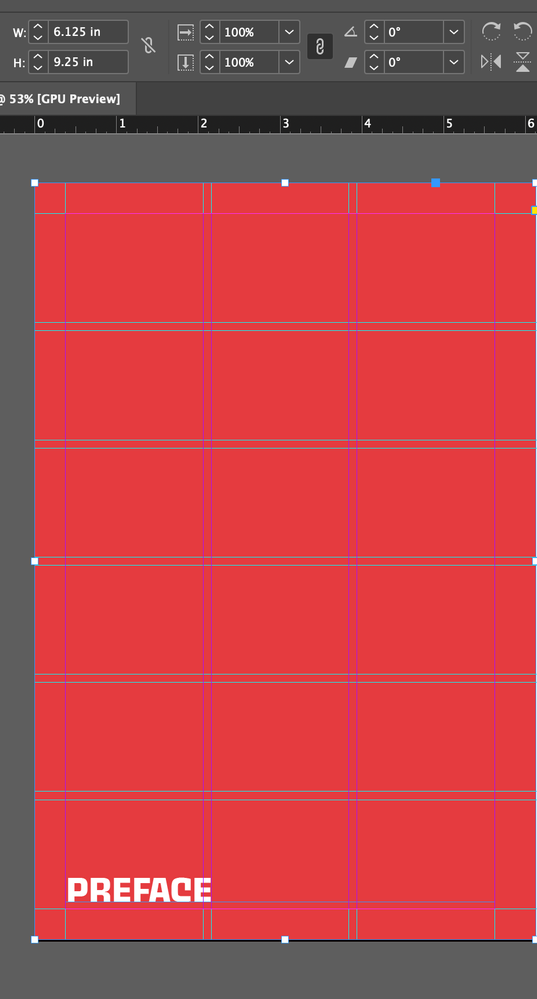

I'm having issues with the KDP previewer regarding a couple of chapter pages that have a background color (a solid color shape). My book is 6x9", and since there are these pages that have a background color that extends to the edges, the document is set to 6.125x9.25" with bleeds. The margins are correct and exceed the minimum requirements.
When I remove the background color (delete the shape), the error goes away, but I want to keep the background color for design purposes.
How can I resolve this issue? Did I do something wrong?
I've attached screenshots of the document setup, the actual document, and the KDP preview.
Thanks in advance for your help!
Screenshot 2024-06-21 at 10.00.47 PM.pngScreenshot 2024-06-21 at 10.01.00 PM.pngScreenshot 2024-06-21 at 11.22.48 AM.png

I thought so in the very beginning, and tried moving the text. I deleted the text box for the test, and the error is still there.
The only thing that makes the errors go away is deleting the red shape.

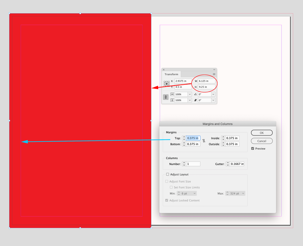

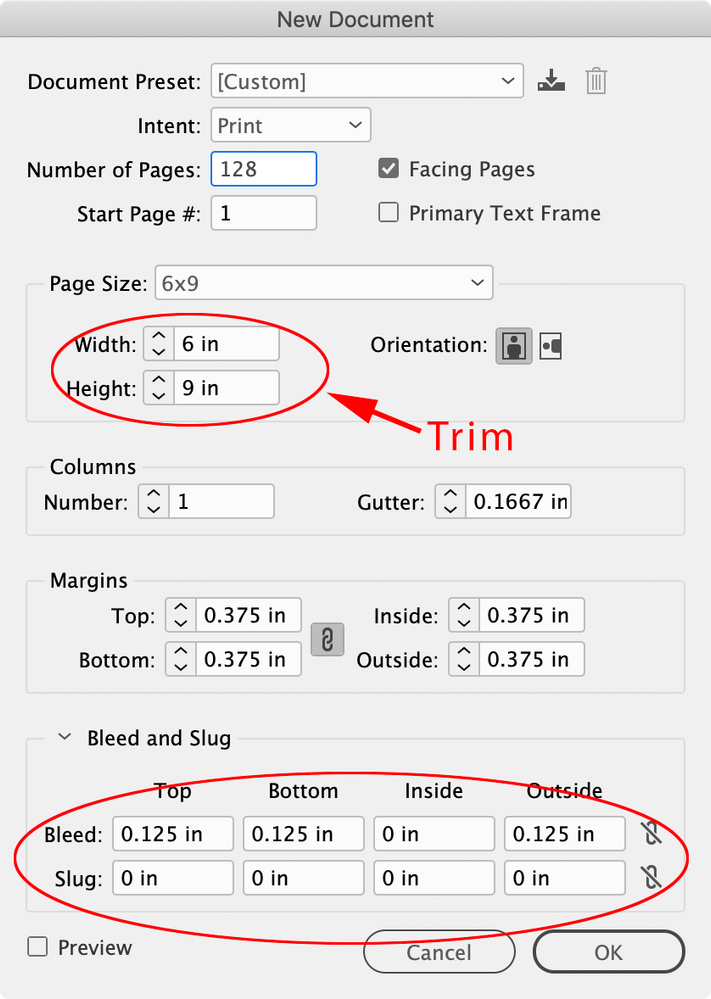

Hi @yerkanian , you say your book’s trim is 6" x 9", but you have added the bleed to the trim—the setup should be this:
The .375" margin is the distance to the trim, because you have included the bleed with the page dimensions the distance from the margin to the trim is actually .25"

Hi @rob day
That's the KDP's requirment, to include the bleeds into the actual document size and not as settings in the indesign. Their system doesn't recognize PDF's bleeds.
Jun 21, 2024 Jun 21, 2024
Uh, no. You have to set up a page trim size, and then specify bleeds on top of that. You can't just combine them in one page size.
If even one page has bleeds, and you've specified bleeds in the upload, all of the pages can (should) have bleeds defined, even if they're empty.

Lay your pages out at trim size. Add bleeds. Make sure your background rectangle is exactly bleed size. Anything else you're reading or inferring from KDP is wrong.
ETA: You need an inside bleed as well for KDP. Change that to 0.125 as well.  This varies with the print process and sometimes the phase of the moon. Make sure your bleeds are set up correctly (0 inside, 1/8 inch others) and that you have no content in the live area. If that fails, add a bleed to the inside and try again. This is not a 100% predictable setup.
And again, make sure there is NOTHING over or close to the live content margin. That throws bleed errors even if page layout and bleeds are perfect.
