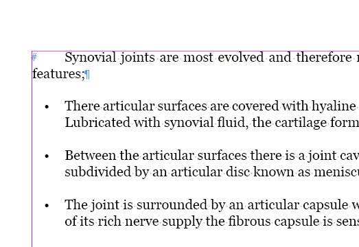

Hi. My paragraphs are working well with my Keep Options settings, except one (Synovial Joints). The settings don't affect the paragraph no matter how I change the settings when the other paragraphs do. What I did wrong, please.

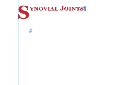

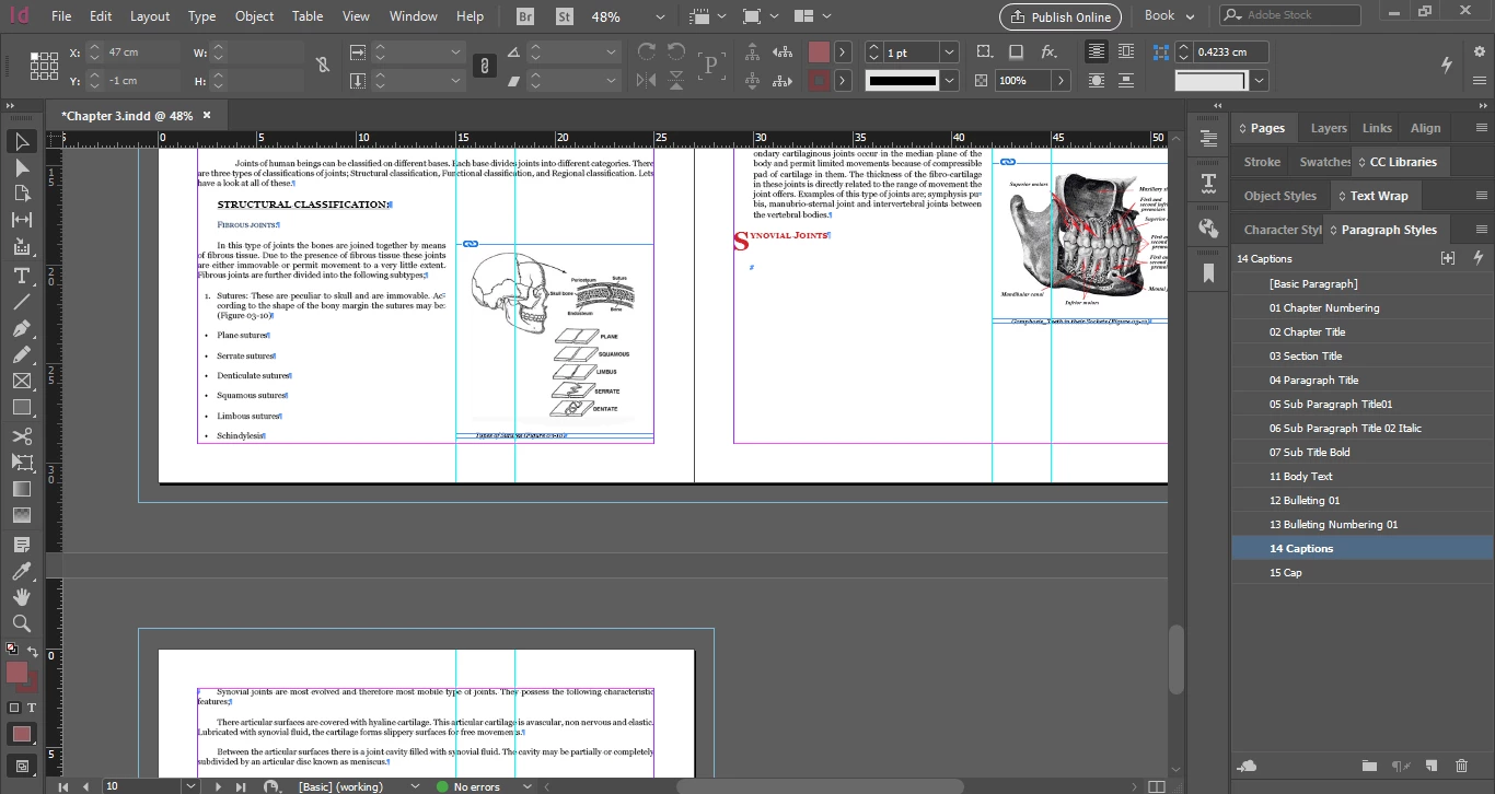

So you want to keep the red head "Synovial" together with the following text. Are you sure the text thread does not stop at the bottom of that first frame? Text frames need to be connected for Paragraph Keep Options to work.

Hi. Yes. This fixes it. Thank you.

Hi  Zaid: I see two areas to take a look at. The first is that there is a hashtag under the heading synovial joints which is an end of story marker. That means that the frame with the heading is not connected to the next frame. Once you get that straightened out, in the Keep Options dialog box you will want to enable Keep with Next one (or two) lines, to keep the paragraph under the heading together with the heading.

Hello Barb. Yes, the problem is the link as you mentioned. Once it connected, the Keep Options works.

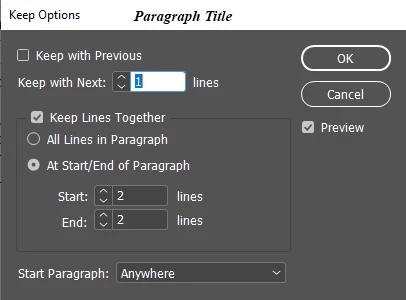

Hi, can you provide a screenshot of "keep option settings" of the paragraphs?

Hi
