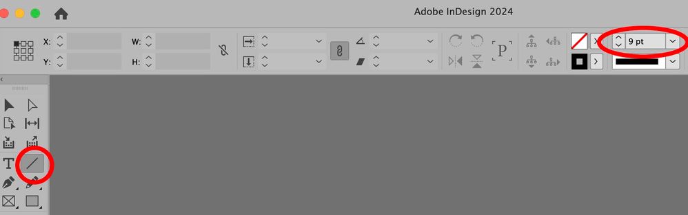

There is no file open, and my screen looks like this. I can select the Line tool (circled) and set the line weights (circled)
Votes

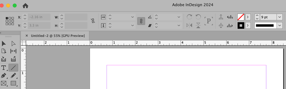

After making those settings, when I create a new document, the new document now has those settings:
Votes

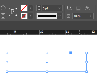

I wonder if it's a Windows vs Mac issue. Deselecting All, then setting lineweights looks like it works, until I draw something, upon which the setting assigns a zero value to it. Here are the settings with nothing selected.
Here they are upon drawing a line. The lineweight, fill colour and stroke colour all revert.

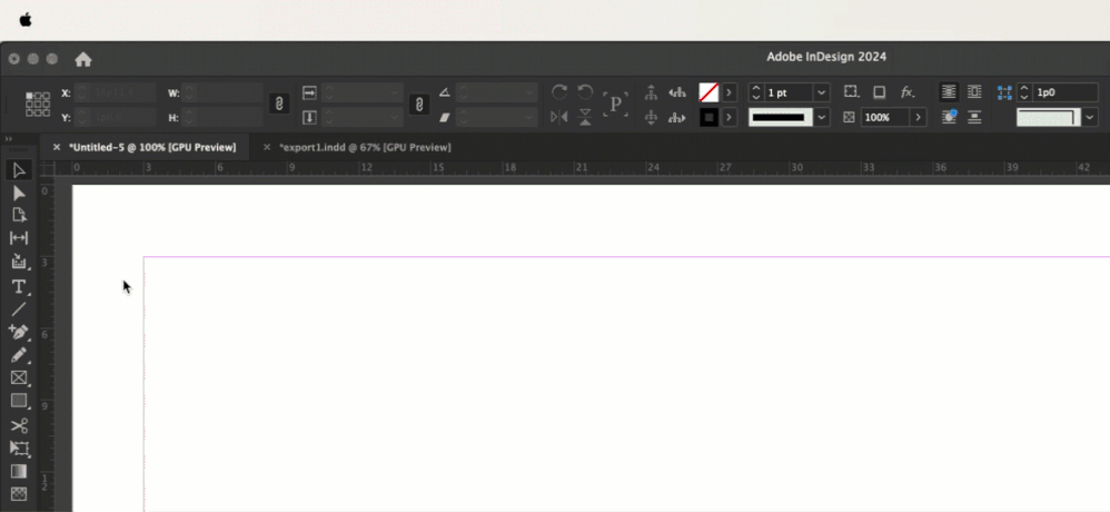

Hi @Darrell M:
As per @Laubender, the Rectangle tool and the Rectangle Frame tool work differently, yet look very similar, particularly if you have View > Extras > Show Frame Edges disabled. (The Rectangle Frame tool will show an X inside until we an image). I'm thinking Show Frame Edges is disabled on your system?
FWIW, the experts on this forum are pretty well split between macOS and Windows. For example, Steve is on a Mac, I think Uwe is Windows, I'm primarly on a Mac but also have InDesign on Windows. The application is basically the same: slight keyboard shortcut variations (and sometimes, platform-specific bugs) but I think this is an issue of understanding how InDesign works, and not a new bug.
Please feel free to continue to clarify until you get the answers you need—that's what we are here for.
