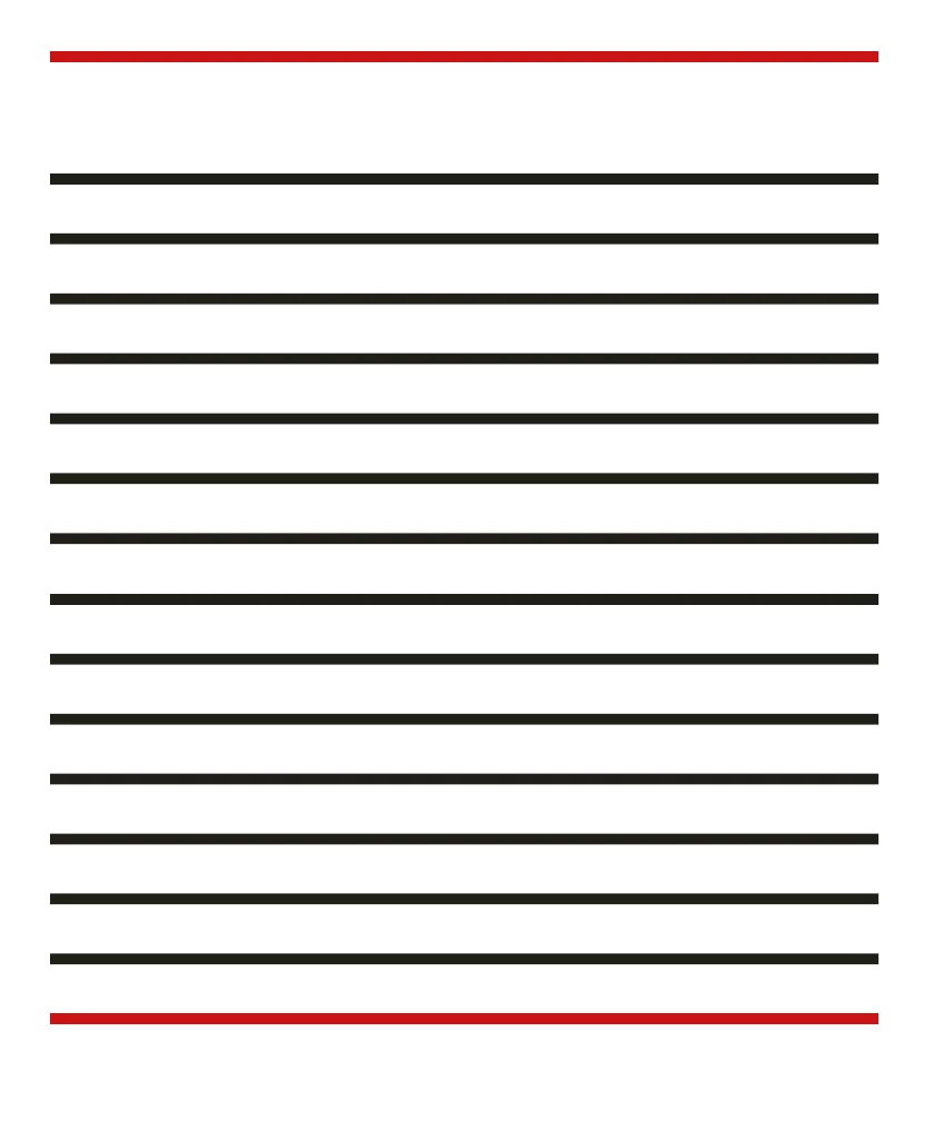

I was watching this video on YouTube (7) Master the Gridify Feature in InDesign - YouTube
At about 3 minutes, he demonstrated a technique I had no clue existed, in which a line can be interasctively duplicated while holding the Alt + Shift keys. The following Is a screen capture of my result: the red lines show the starting and finishing lines, while the intermediate black lines shows the lines created interactively using the "Gridify" feature. I made the lines thicker to facilitate following:
 Now, for the life of me, I can't find how to control the initial spacing between the lines?
I also wonder how is it that when I select ALL the lines and pull them down from the bottom, the spacing between the lines "increase"? Having a difficult time wrapping my head around this behavior.

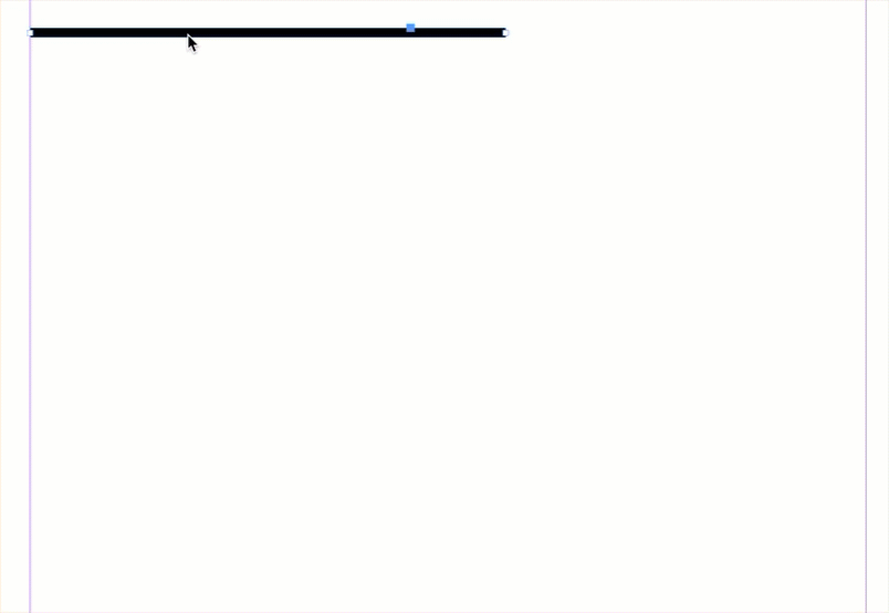

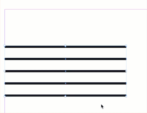

October 30, 2023
Hi Roger:
Initially you were asking about adjusting the spacing:
quote
Here is my first screen capture addressing how to adjust the spacing between the lines, both while using gridify and afterwards.
s
Now you seem to be asking about maintaining the spacing...
quote
simply selecting all the lines and dragging the last line down, all the other lines "reposition" automatically, maintaining whatever spacing there was between each one?
In my second screen capture, I was trying to confirm that after gridify is complete, you can move all the selected lines by dragging the bottom one. InDesign is not spacing them equally when I drag the bottom line—gridify did that already. Moving them simply maintains the spacing, as you can see below.
I hoping that at this point, we have fully addressed both of your questions and you are back on track.
~Barb

Hi @Roger Breton:
You control the intital spacing between the lines by dragging up or down, before you release the mouse button.
After you release the mouse button, the easiest option to change it is to use the Distribute Spacing button on the Align panel.
~Barb

Barb Binder
October 30, 2023
Hi Roger:
quote
Please allow me to point out that, in your video, you use the Align panel to space the lines vertically but it's not necessary to do so, according to the bevior I observe here: as long as all the lines are selected, dragging the last one down automatically spaces them all equally?
This comes down to timing:
  • If you are still holding down the mouse button—in the middle of the gridify function—then yes, you can adjust the lines up or down by dragging the last line.
  • Once you release the mouse button, gridify is over. The easiest way to adjust all the lines is to use the Align panel. If you just drag the bottom line down at that point, then no, you will move all the lines but will not be adjusting their spacing.
~Barb
