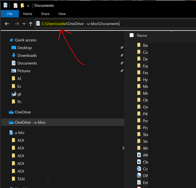

We have an issue with linking images from SharePoint Online document libraries. All the info I can find online points towards using OneDrive sync, but that doesn't work. As per the below screenshot, you can see that the path for the image is still local. Anyone else who wants to edit this file, won't be able to see this image. Is there a way to link via URL or directly from a SharePoint Online library?

On Windows for Dropbox, OneDrive, SharePoint etc the path to the synchronised folder starts C:\users\USERNAME as you can see in the below screenshot. You're right in terms of the path after this is the same, but with InDesign it keeps the first part of the UNC path which is why it breaks for other users. I.e. on another device C:\user\sedw doesn't exists, so InDesign can't find the image file.
