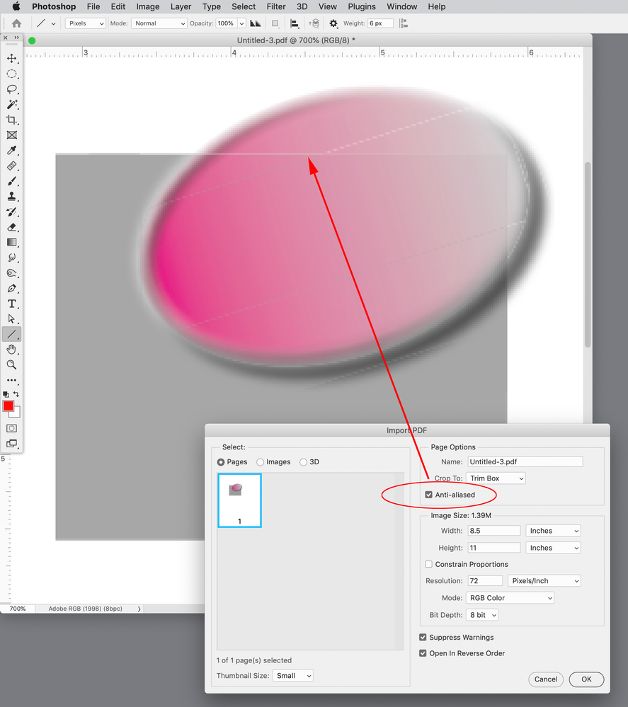

May 12, 2022 May 12, 2022
2) Rasterize the PDF in Photoshop
Hi @Mara R , I don’t think this is OS related. The reason you are getting lines in the rasterized PDF is probably because you are allowing it to Anti-Alias in the Open PDF dialog.
This is a good demonstration of why stitching is not really a problem in PDF/X-1a exports for high res printing (a RIP should not be anti-aliasing). If I open a flattened PDF/X-1a with Anti-Aliasing turned on at a low resolution, the stitching artifacts will be in the file because of the edge anti-aliasing—same thing happens when a PDF/X-1a is displayed on a low res monitor and the PDF reader allows anti-aliasing:
If I open a file at a high resolution with AA turned off, I won’t get any stitching.
If I don’t want the extra res, I can downsample. The comparison at 72ppi:
