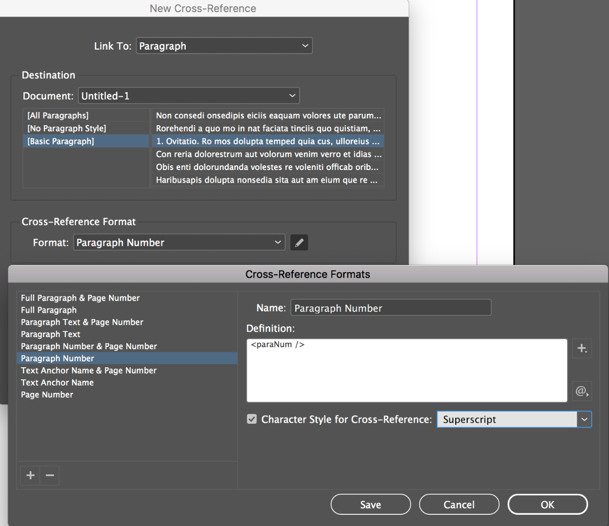

    6. Click the Pencil button to edit the format
    7. Refine the X-ref format (just do this once):
      1. Add a Name for the X-ref format (i.e., Notes)
      2. Add a superscript character style, OK, OK
    8. Now that the format is set up, just add the rest of the x-refs from the first dialog box.

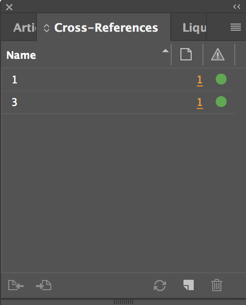

  4. Use Window > Type & Tables > Cross Reference panel to make sure the links are up to date. Use the update button the bottom to refresh the links.

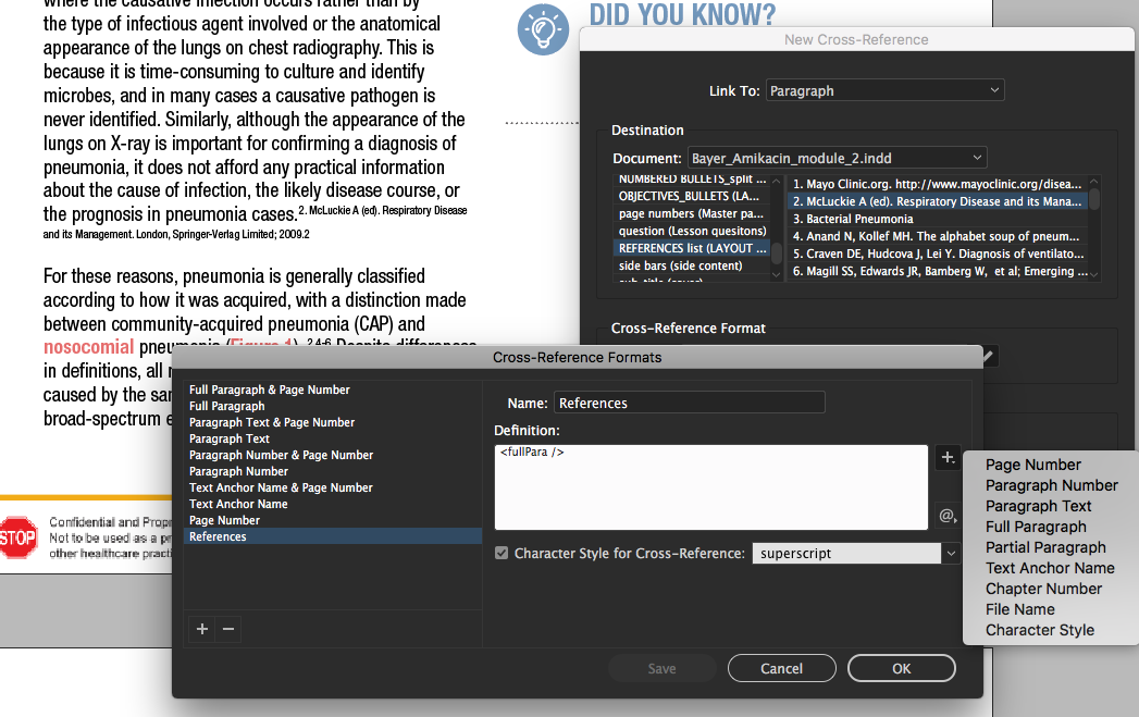

I followed the steps, feel like i  am almost there. but my subscript reference shows the entire reference. how do i display only the entry number?
Guru ,
Nov 07, 2017 Nov 07, 2017
got it to work. thank you.

editorial sent me a whole new document for typesetting. and the references all changed. i copy from the word document text for the references and replaced the list i notice copy in my indesign layout, the corssreference panel exploded with red flag icons.  I did an "undo".. lol

Let's start with the last question. I have two jobs—I work as a trainer and I take on freelance layout projects. I don't accept files for layout unless they are already in final form, and I charge a considerable amount for correcting the mistakes that were in the files that were delivered. (I don't charge for formatting updates—if I made a layout mistakes that's on me.) By being very clear about this upfront, I have successfully eliminated the workflow the you are in right now—where you are laying out the same file three times in a row.
Now, you have two options to replace the references. You can copy and paste to replace each reference, leaving the link intact, or replace the entire list and use Relink Cross-References in the panel menu, much like relinking images in the Links panel. Knowing how to do both is valuable, but of course after you understand how they work, pick the workflow that you can complete more quickly.
