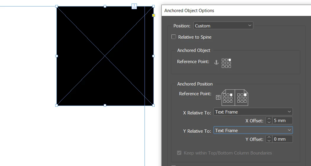

Actually there is a bit of a problem with this ...
In this example, there is an image on the second page in it sorrect position:
This is WITHOUT the Custom setting selected.
Choose the custom setting for the object style and this happens:
I can't figure out why! Any suggestions?
If I un-check the Keep within Top/bottom column boundaries checkbox for the object style, that's better but then the image falls off the bottom of the page.
Thanks!
