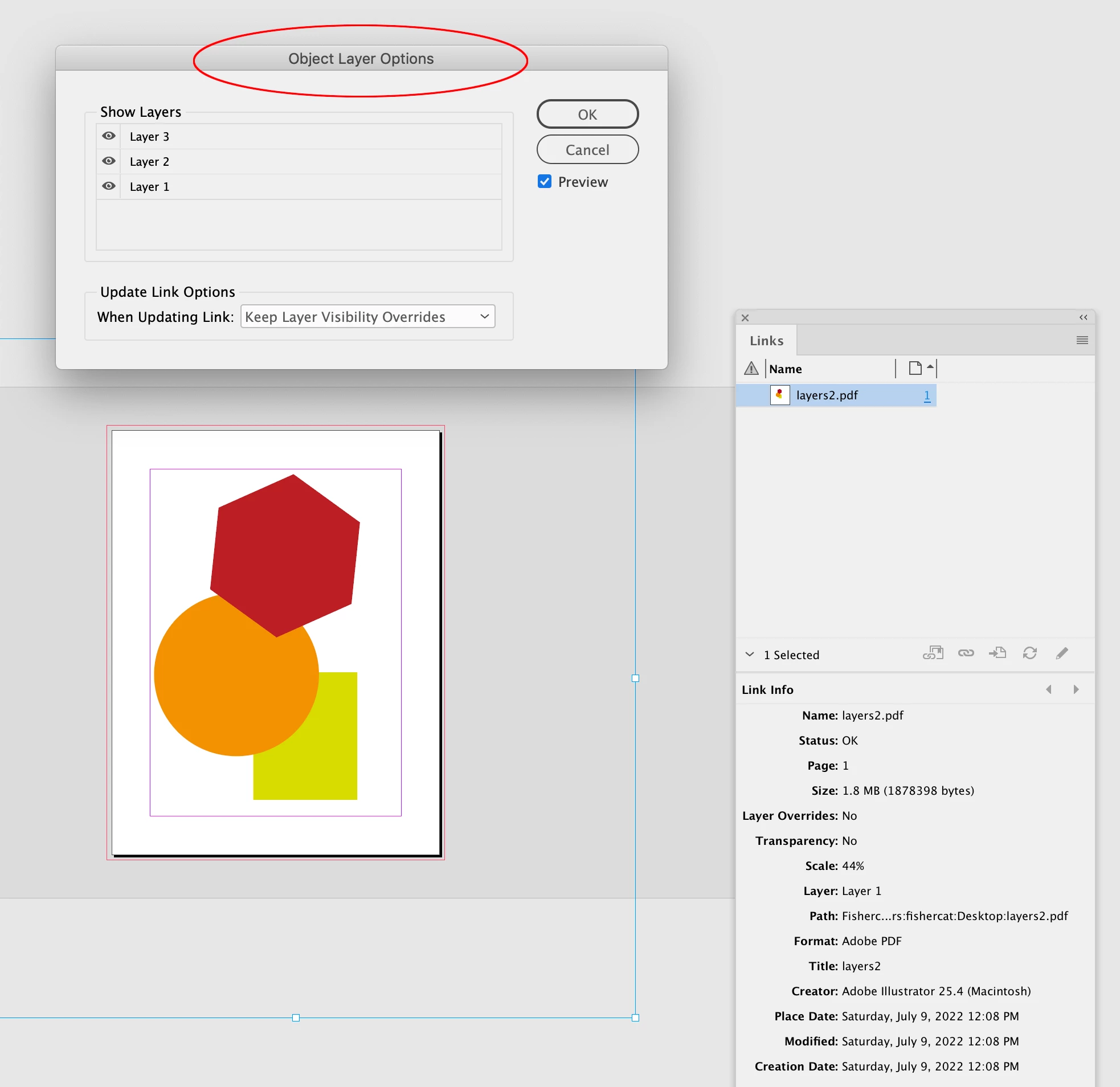

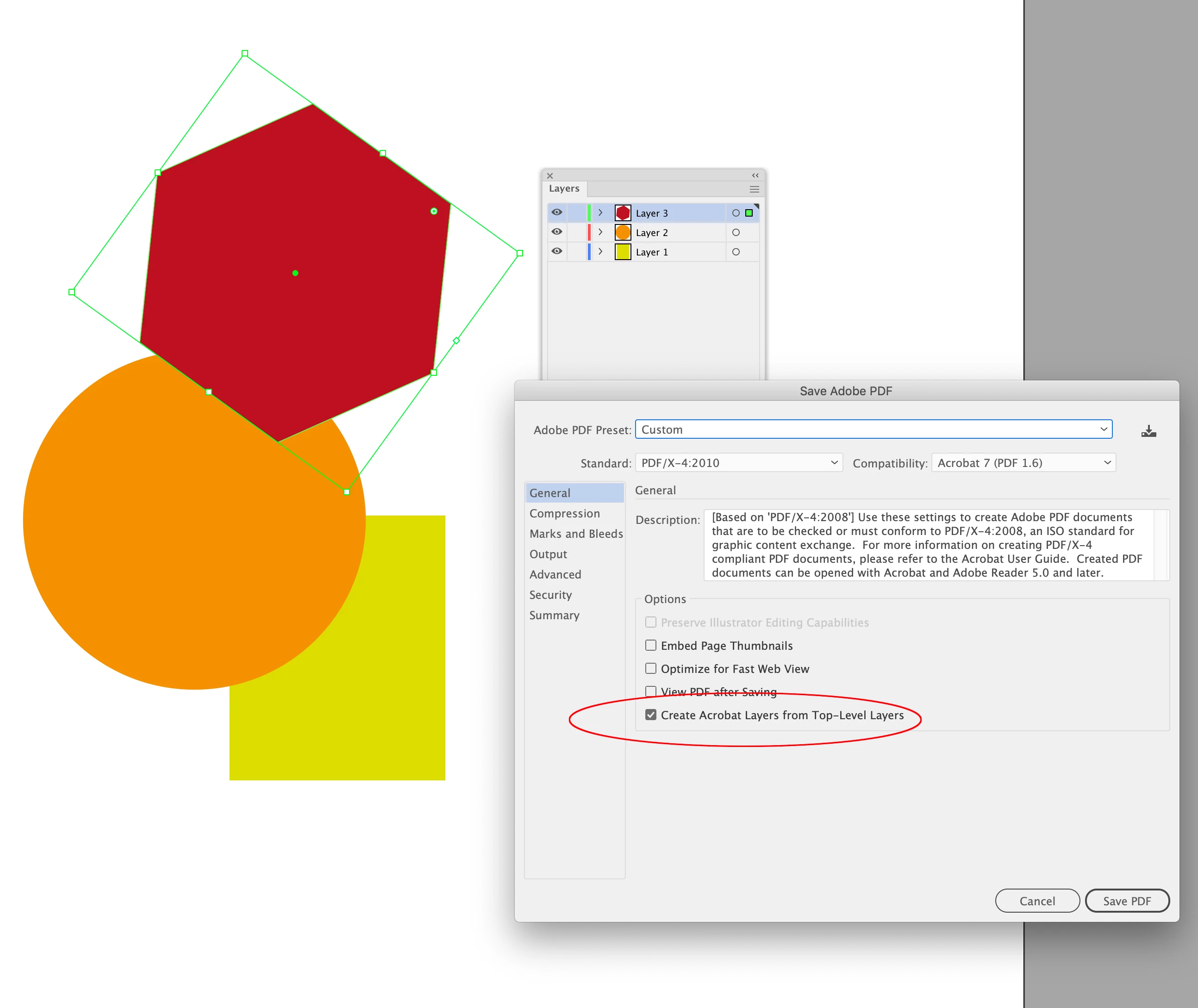

Hi @displaced7 , When you Save As PDF/X-4 check Create Acobat layers...
Then in InDesign Object Layer Options will be available:
A few thing to watchout for with PDF/X-4, you won’t be able to Edit Original, so you’ll need to keep an editable version as .AI. For me that’s a non starter, but in your case it could be a fix because the placed images are going to get compressed and embedded in the PDF, which might fix any file corruption.

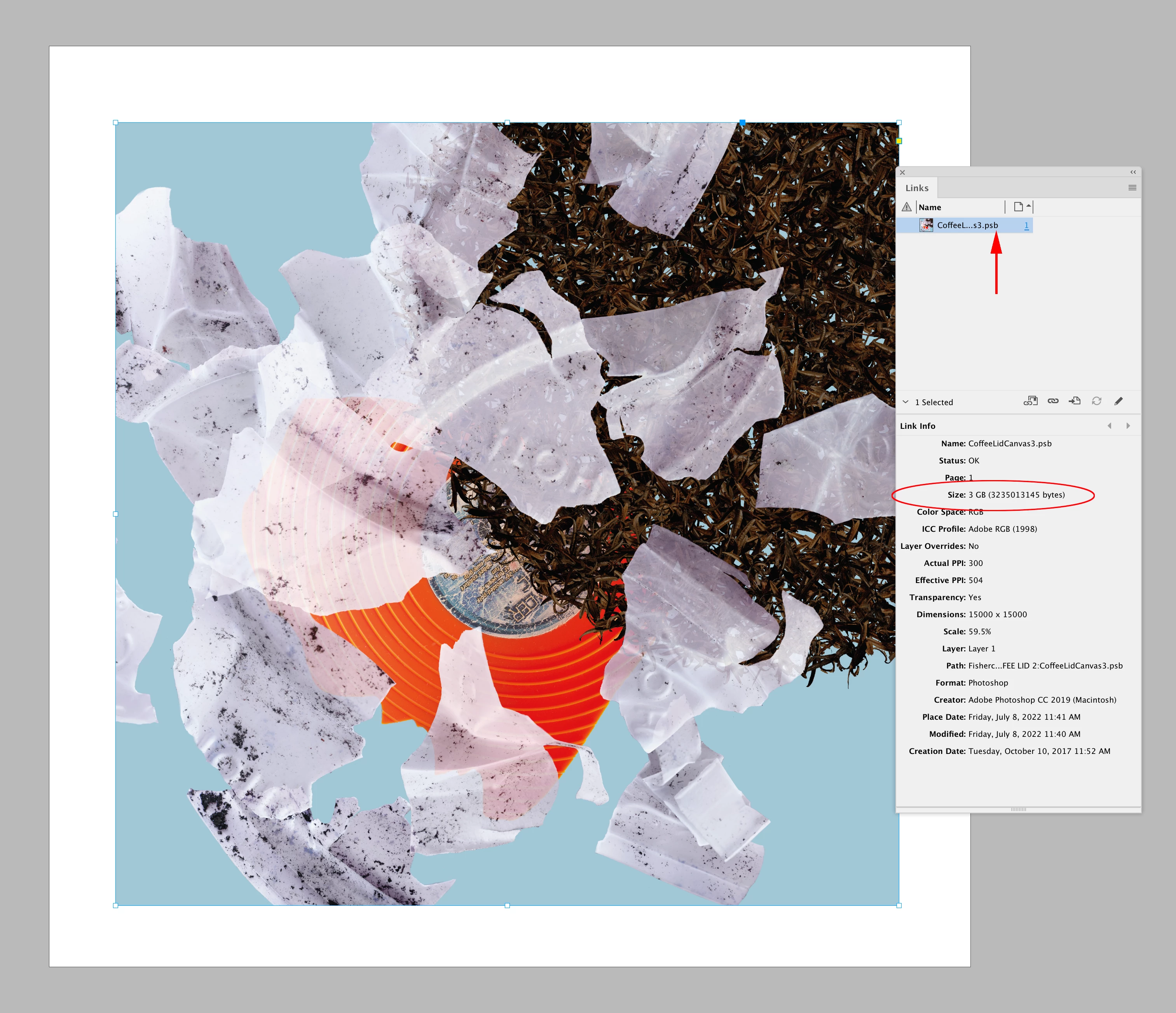

I regularly place large Photshop files without any problems—this .psb is 3GB—so it could be related to overly complex vectors in the AI file rather than the file size.

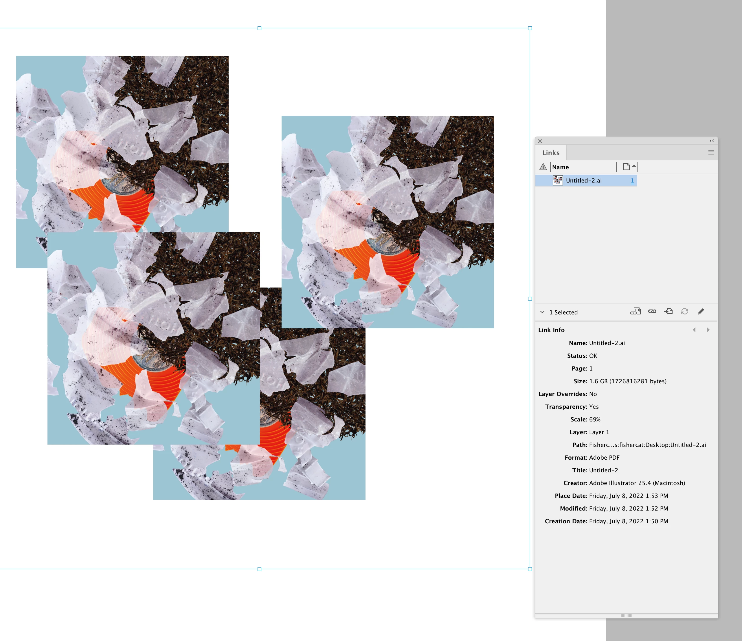

Doesn’t seem like there is a file size limit—here’s my 3GB .psb paced 4x in an Illustrator file with the .ai file placed in InDesign:
Took sometime to make the proxy image, but it worked.
