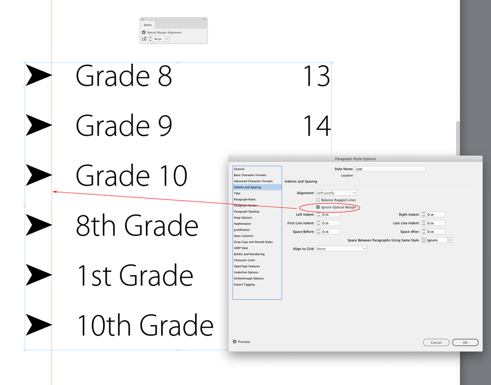

Turn off the optical alignment for this story.
Community Expert , Sep 23, 2021 Sep 23, 2021
It looks like it might be your Optical Margin Alignment setting.
If you are using a Paragraph Style for your bulleted list try checking Ignore Optical Margin in the Indents and Space tab, or turn it off in the Story panel

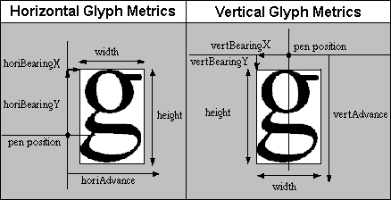

I have forgotten most of the terminology for this; I learned it two generations of forum software ago. I think it boils down to tab stops aligning to the bounding box of the glyph determined by the side bearing value.. Here's an image from the TrueType specification:
