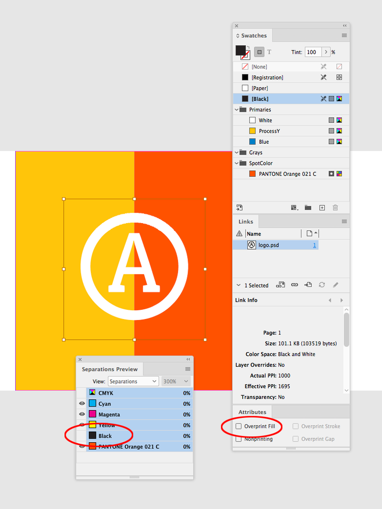

Bitmap images—Black and White in the ID Links panel—can be set to Overprint in the Attributes panel, and if you set the parent frame’s fill to None the white pixels will effectively become transparent even though there is no transparency on the page.
So a placed Bitmap with its parent frame set to white:
Set to [None]
The Bitmap selected and set to knockout:
The bitmap set to Overprint in the Attributes panel with the Black plate hidden:

 Is "Overprint" reserved for pure black?
[Black] will only overprint the CMY plates when their value is set to 0, so with CMY set to 0:

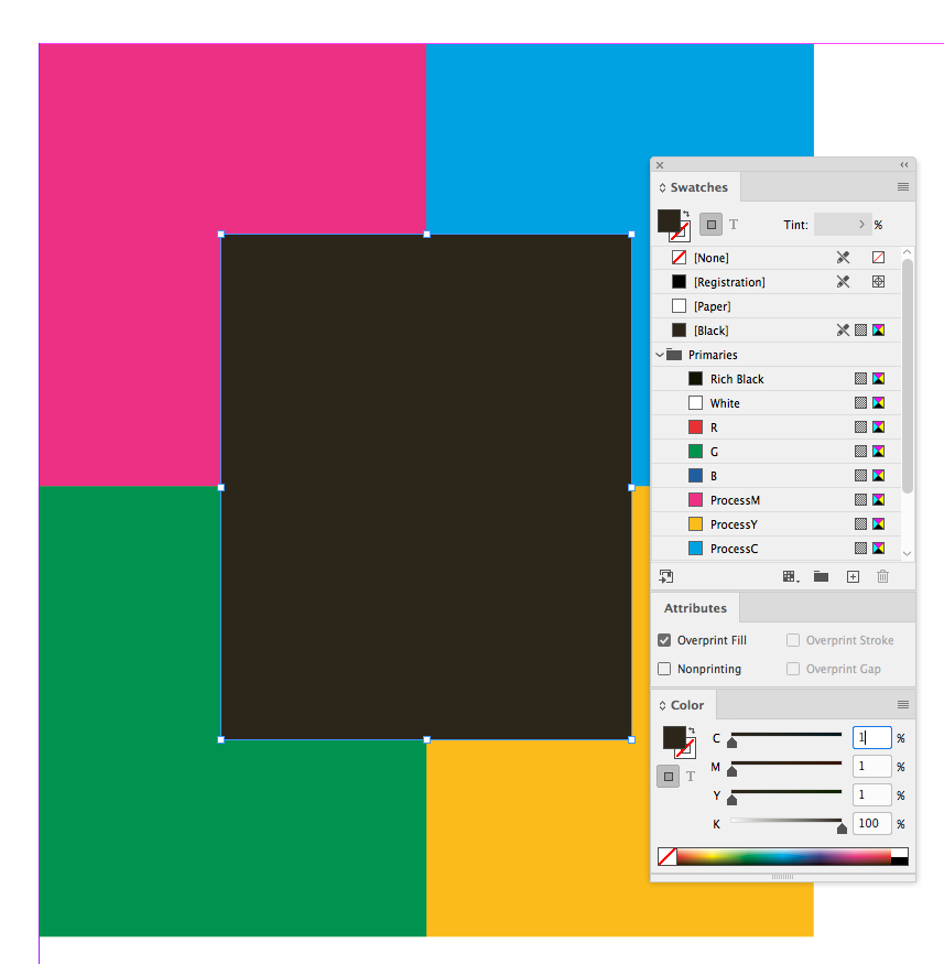

If I set Cyan to greater than 0 Black does not OP my 100 cyan fill (note that the document’s CMYK profile here is Uncoated GRACol and the black appears gray, which would be the case on and uncoated sheet.
If CMY is set to 1 black knocks out:
A rich black also knocks out but its appearance changes because of the extra CMY underneath
