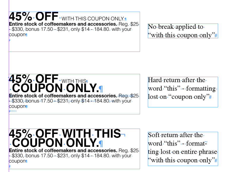

Thanks again. This can get convoluted, so I appreciate the advice. Now I am seeing instances where the line "with your 25% savings pass!" has to be broken via a soft return (shift + return key) When broken, the second line no longer starts with the word "with", so the grep style is not applied to the new second line. Is there a way to tell a grep style to carry on through a soft return?

Here is a screen shot of what happens when I do a hard or soft return

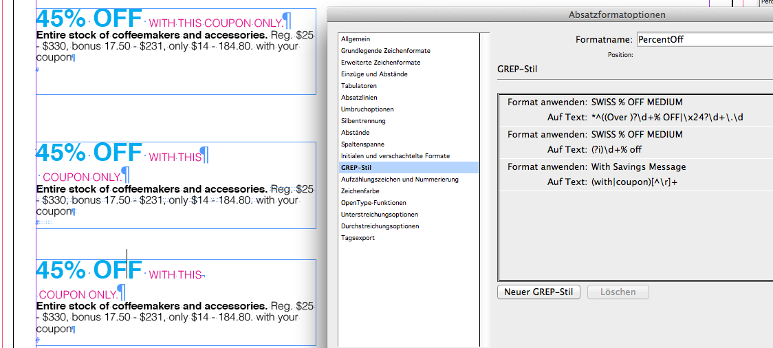

Enthusiast ,
Oct 22, 2014 Oct 22, 2014
Thanks for your samples. First of all, live isn’t always easy 😉
Apply some colors to your character styles and you will see, that your first style isn’t honored (OFF > off)
Second: It is a big difference for grepstyles, if you enter a softreturn in the same paragraph or you enter a hard return (new paragraph).
Since the scope of grepstyles is paragraph based, your second para did not know the first one.
So in your special example you could use (with|coupon)[^\r]+
That means, search for: with or coupon, followed by anything that is not a hard return, multiple times.
But if you have other phrases, this may not work or must be extended.
