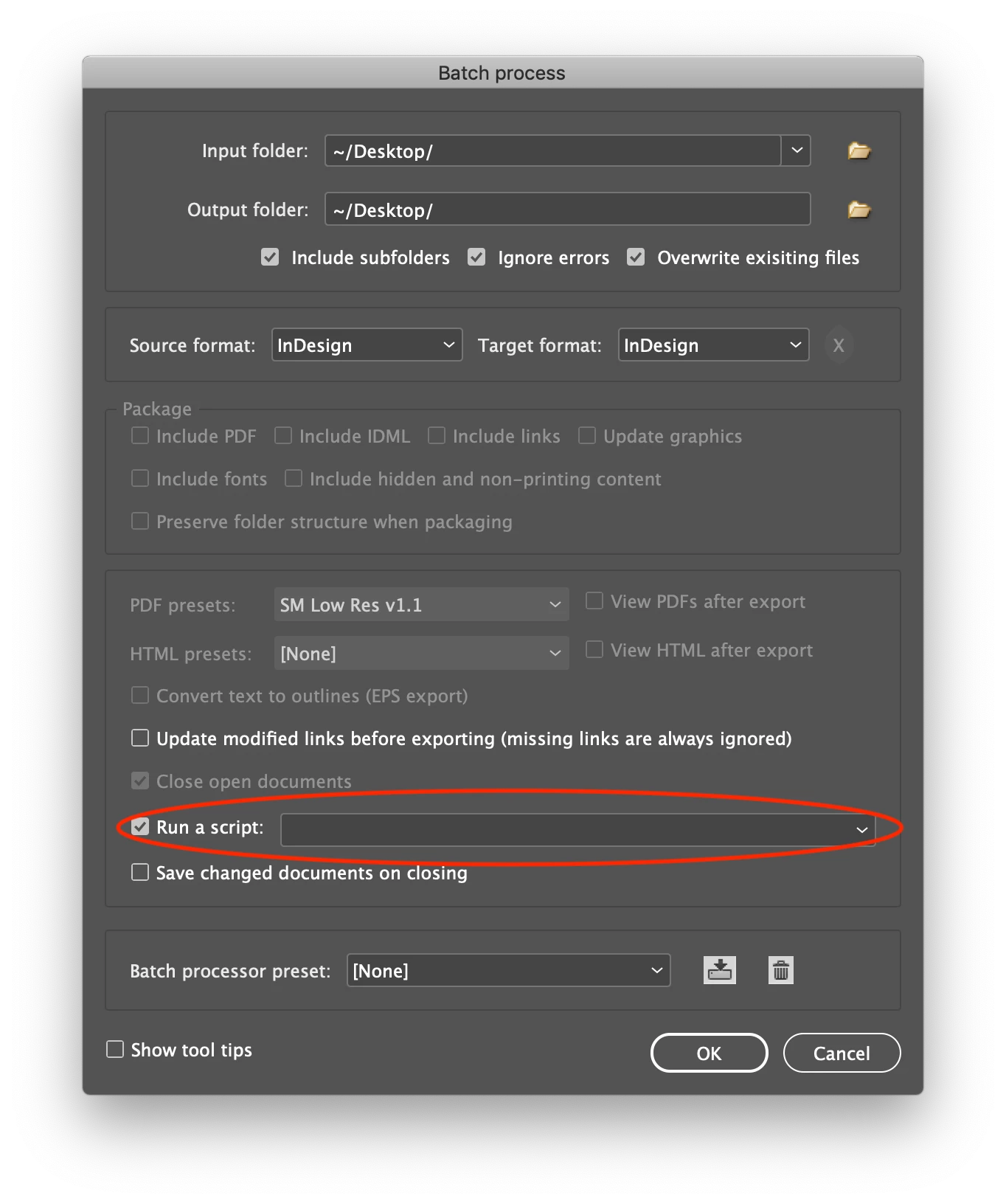

You could use Peter Kahrel's batch_convert.jsx to run either of the scripts I posted to run on all the Indesign documents that need to be proessed in one shot.
https://creativepro.com/files/kahrel/indesign/batch_convert.html
Note: all three swatches must exist in the document(s) for this script to work.

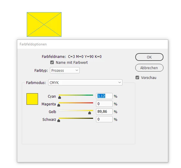

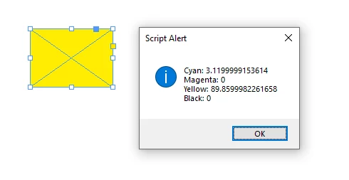

* I said: "close" to the values, because InDesign's UI will never reveal the super-eaxct values with 13 digits after the dot if necessary. So at best a script could start with a selected object like a rectangle or some text where this color was applied to as fill color. Then it's easy to determine the unnamed color.
Below two screenshots with a sample CMYK color with quite some different values revealed by name in the UI, by color value in the UI and by the "true" color value revealed by a script alert:
Name: C=3 M=0 Y=90 K=0
Values revealed: 3.12, 0, 89.86, 0
You see, InDesign is able do do some rounding when it comes to naming a color after the color values that are revealed in the UI:
Even more, the exact values of the color's colorValue array can only be shown with a script:
Cyan
3.1199999153614
Magenta
Yellow
89.8599982261658
Black
