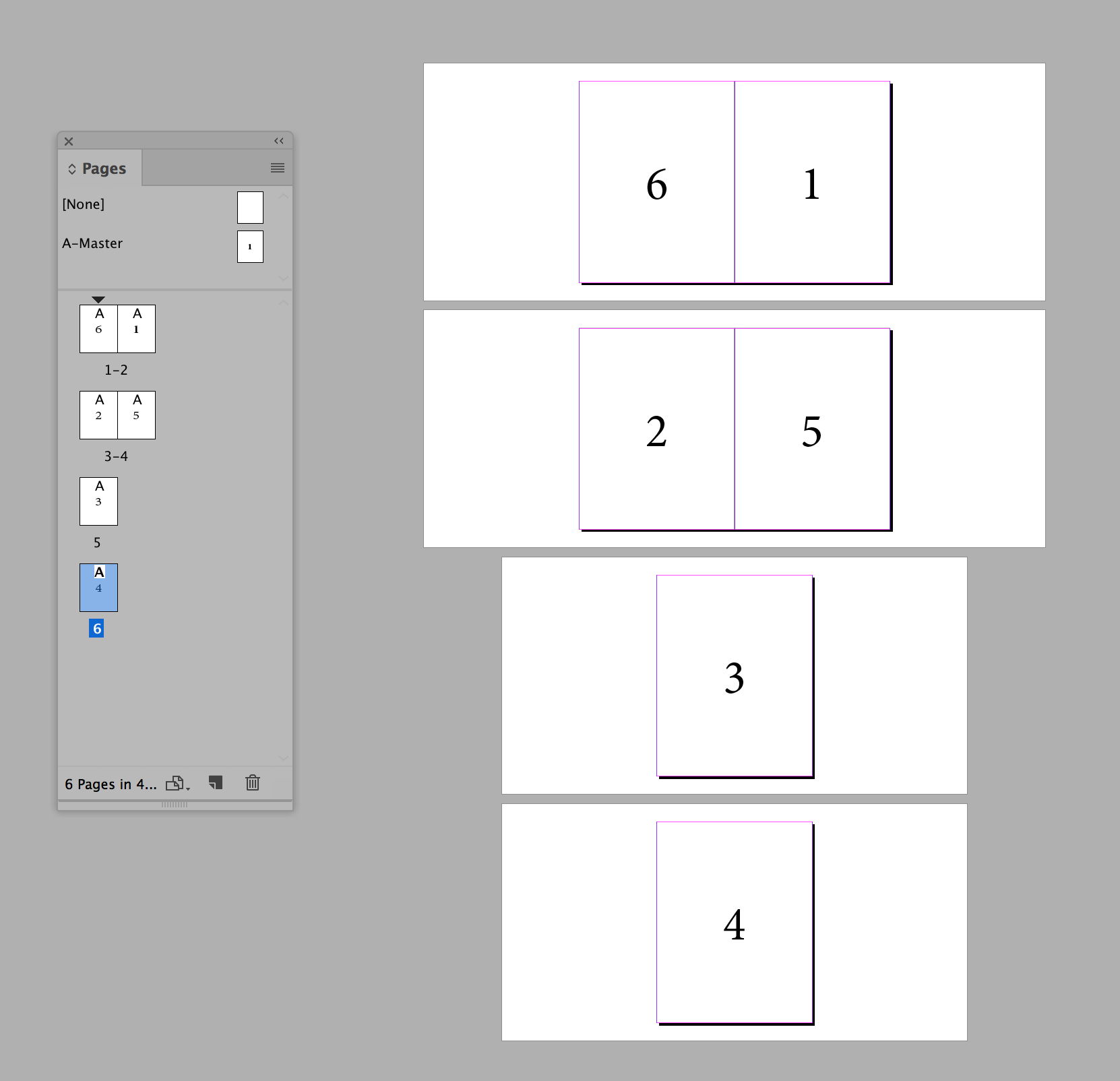

You can set the job up as in the screen shot below:
Create the job as 8.5 x 11 inches single pages (make sure that Facing Pages is NOT checked in the New Document dialog window). Initially the six pages will appear singly in the Pages Panel and in the actual document. After unchecking "Allow Document Pages to Shuffle" in the Pages Panel pull-down menu you will be able to drag the pages in the Pages Panel to set the job up as shown. When you drag each page up to create a spread place it close enough to the right of the page that is above it that you see a bracket appear. When you see that bracket let go of the page and it should pop into place. One major bit of warning: If you intend to have any bleed you should know that most printers will not print color or image all the way to the edge of the paper. Printers need an area of the paper for their gripper so at least one edge of the paper will be blank by up to a quarter of an inch. If you are intending to have bleed then add at least an eighth of an inch bleed and print the job on a larger size paper (12 x 18 usually works quite well) with crop marks so that the job can be trimmed to size.

Bill, this helped quite a bit, but when I went to go print it to pdf, all the pages were still letter-size. I combined your advice with some other instructions to change the page size of two pages, and success!

You can set the export to pdf for spreads in the first section of the dialog window and the pdf will have the correct page sizes.
