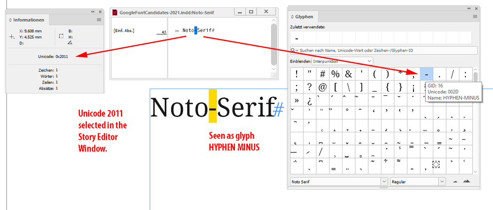

did you select the hyphen and checked its Unicode codepoint value with the Info panel?
Also did a test with the Noto font.
I applied the special character NONBREAKING_HYPHEN with a little ExtendScript (JavaScript) script that assigns the special character to selected text:
// Selected text will change to that special character:
app.selection[0].contents = SpecialCharacters.NONBREAKING_HYPHEN;
Below the strange result. InDesign's Info panel is showing Unicode 2011 for the selected hyphen.
The Glyphs panel is showing Unicode 0020 HYPHEN MINUS at the same time:
If I do an Inventory Report with an exported PDF/X-4 in Acrobat on the used fonts, Acrobat is showing Unicode 2011 for that glyph; so that special character is exported right, I think:

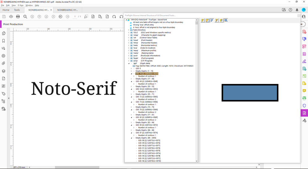

What makes me a bit uneasy is Acrobat's Preflight on the font with
"Browse Internal Structure of All Document Fonts" where it states that the used shape is U+002D:
So the question now is: What is that particular tool doing with a PDF file?
Clearly the report is telling that U+2011 is used. And that glyph's shape is from U+002D…
( My personal interpretation that could be wrong. )

If I was designing a font, I might well use the same shape for both of these code points (that is, put the same GID for both Unicode entries to avoid wasting space with duplicate copies of the same shape). There seems no typographic reason to make them look distinct. I wonder if doing this in a font looks, at some level, like a substitution.

It seems that the software you cannot disclose is looking at the wrong spot in a PDF.
The inventory report of Acrobat Pro is listing the right Unicode code point.

All in all you need a software that is checking the InDesign document itself. Not the PDF where this kind of information is not relevant anymore. The shape of the glyph is the right one in the PDF. No issue at all. If you want to get information if the glyph is a non-breaking hyphen and you must build on this in the steps that follow in your workflow, extract the data from InDesign and not from a PDF.

Oct 04, 2021 Oct 04, 2021
"I don't know half of how you have found all that info but that really does highlight the issue."
Acrobat Pro DC:
Print Production > Preflight > Options > Create Inventory…
Print Production > Preflight > Options > Browse Internal Structure of All Document Fonts…
