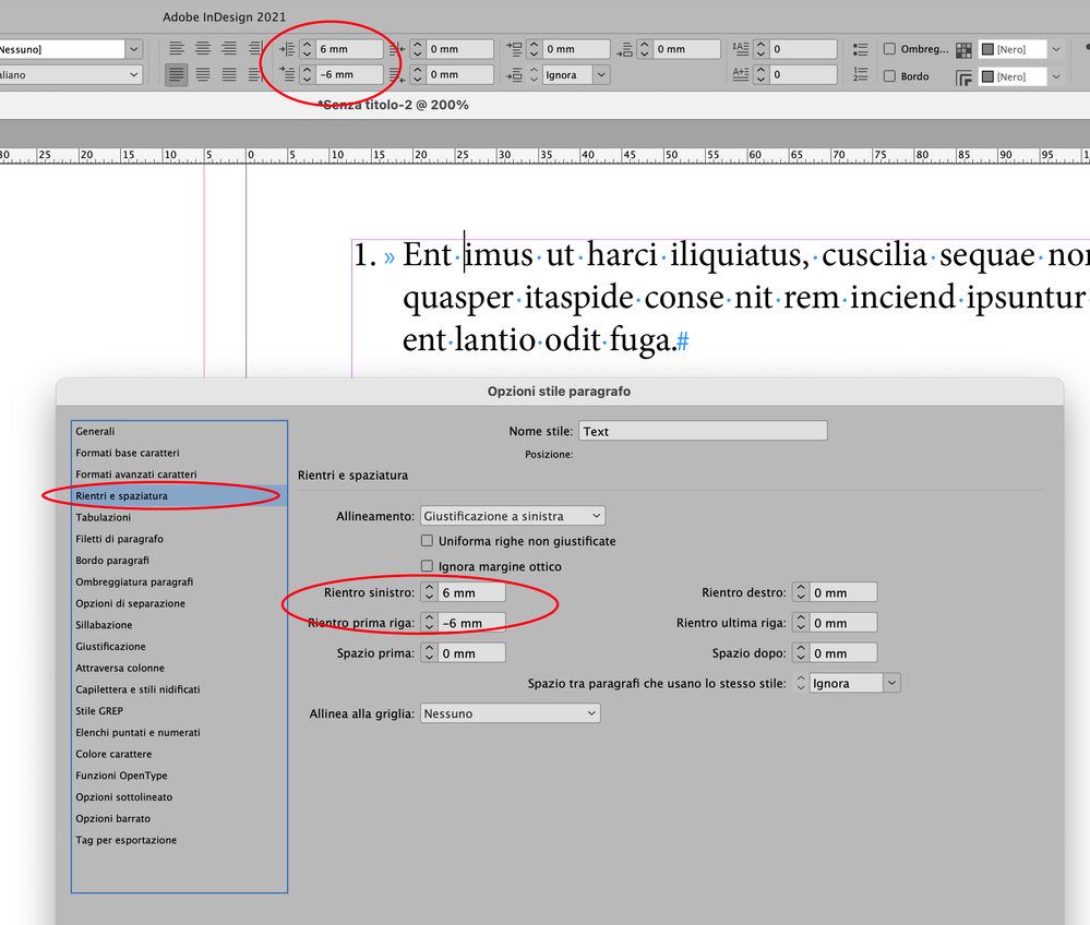

did you try, for example, this settings?

Explorer ,
Feb 18, 2021 Feb 18, 2021
I tried that, yes. This is what I get.

Explorer ,
Almost like that. The only difference is I'm trying to make the numbers align with the edge of the 1st paragraph.

Explorer ,
That worked, very creative! I would never have thought about using a right alignment. If you had a chance to share the logic, I'd love to hear it. Can't quite figure it out.

Explorer ,
OK, well the logic is still escaping me, but I got what I was looking for using 25 ans -6. Thanks!!

Advocate ,
I think you got it, Anthony! Just play around with the settings until you get what you want. That's probably the easiest way for you to learn what I did. Also, you might want to experiment with the numbering alignment. I set them Right, so the decimal points (.) are always aligned vertically. If you align Left, then the first digit of each number will align, but the decimals won't. Your choice.
