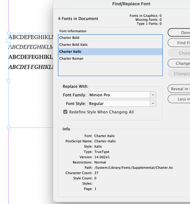

I see no evidence that Charter was ever a font offered in the Adobe Font Library. But Corel/Bitstream certainly did have a Type 1 version of it. But my guess is you are actually using the version that is a supplied system font in Mac OS as a TrueType Collection (.ttc) format). What does InDesign say about it in the Find/Change font dialog under More Info?
That being said, there are definite flaws in that Italic font outline as I was able to reproduce exactly the weird effects you are seeing at certain zooms.
