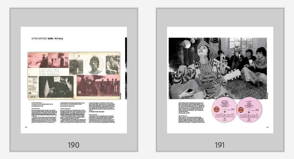

Here's my issue. INDD Page with 5mm bleed all round. including inside gutter. These two pages have fullpage colour backgounds that bleed into the centre of the book. Designed on two INDD pages as a spread, output as single PDF/x press quality pages - produces a mirror 5mm strip on each inside bleed area. Similarly, when theres a full bleed picture on one page and not on the other, same effect. I want Indesign to output to PDF honoring the inside gutter bleed. Printer requirements.black ornage mirror bleeds.pngfull page bw image bleed.pngimage bleed png.png
Votes
Jun 13, 2023 Jun 13, 2023
Copy link to clipboard
Copied
Hi @JayneGould , The original post is from 2012, so you might want to start a new thread. It’s normal for the inside bleed to come from the opposite page—almost all binding methods fold, rather than trim, the spread on the spine, so the inside bleed would be removed by the printer in the page imposition. The exception would be a binding method where the inside edge is trimmed —e.g. Wire-O binding.
