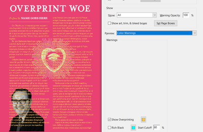

Not seeing any issue here at all
You can go to the settings and view overprint fills
Anything that is overprint will show with the selected colour

When you check the overprinting items via the checkbox it only shows black text overprinting as expected.
Sounds like a communication breakdown.
