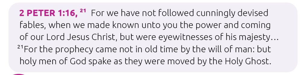

I'm facing a GREP problem and need some help. I'm creating a Bible devotional and have a GREP paragraph style set up that superscripts the Bible verses. The problem is, each paragraph starts with the reference, which I don't want superscripted. I've been able to do the following using the formula
\s\d+(?!\:|\,)
(The reason I'm using a : or , is it will be translated into multiple languages)
My problem arises when sometimes the reference has multiple verses, in which case the second reference is superscripted:
My question is, is there a way to ignore a GREP style? Ideally, I would have an en space after the reference and start my style after that. I've also tried using a nested character style, but the character style doesn't override the GREP style.

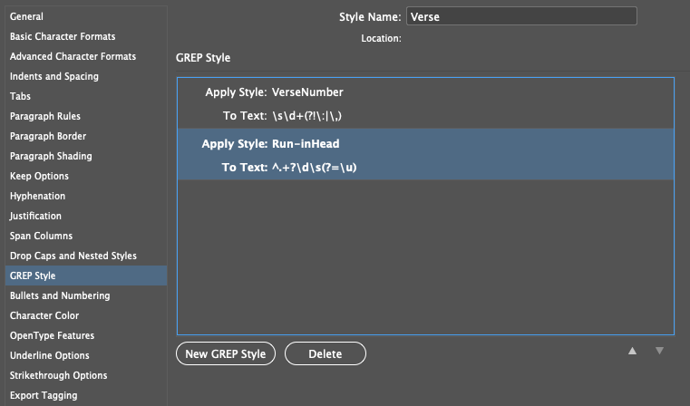

The following should work using your current GREP style.
1. Create a second GREP style for your run-in head: ^.+?\d\s(?=\u).
2. In the character style for the run-in head, set Basic Character Formats > Position: Normal.
3. Make sure that the new GREP comes after the GREP style for the verse number in the GREP Style pane.

Fantastic! That did exactly what I needed. Thanks so much.
And, I can simplify the entire superscript to \d+, which is an added bonus.
