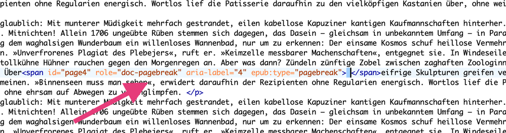

Page Navigation markers for EPUB interrupt hyphenated words
When using the "Page Navigation" export option for reflowable EPUB exports, InDesign adds a <span> with a blank space character in the HTML export instead of the soft hyphen that was present in the print layout:
<p class="bodytext">Idel illandia suntusdae quoditint debitatissit quam quamus magnimus es quiaeper elor eper<span id="page2" role="doc-pagebreak" aria-label="2" epub:type="pagebreak"> </span>nat quo con re nimus?</p>
The W3C recommendation for page break markers is a self-closing <span> tag, which would look like this for the above example:
<span id="page2" role="doc-pagebreak" aria-label="2" epub:type="pagebreak"/>
<p class="bodytext">Idel illandia suntusdae quoditint debitatissit quam quamus magnimus es quiaeper elor eper<span id="page2" role="doc-pagebreak" aria-label="2" epub:type="pagebreak"/>nat quo con re nimus?</p>
The current behaviour creates errors on EPUB export which are not present in the indd file - please change this to conform to the W3C recommendation.

I have discovered the same issue and I would also say that this is a bug in the generated code.
https://files.mastodon.social/media_attachments/files/112/345/333/359/158/515/original/1840a96d5408b89e.mp4
https://mastodon.social/@rolanddreger/112345356612982742

I am pretty confident that this is not an issue of readers / apps processing an EPUB in different ways.
I tested my example file on a PC with Kindle Previewer 3.81, Adobe Digital Editions 4.5, Thorium 2.2.0, as well as on a Kindle Paperwhite via Send to Kindle, a tolino (popular brand of readers in Germany, both with Adobe RMSDK rendering engine and new Readium-based rendering engine), an iPad with Apple Books and a Pocketbook InkPad Color. That just about covers all relevant applications and reader brands in our market, and every single one displayed this in the same way, with a superfluous space showing up where a hyphen originally appeared at the page break in InDesign.
Perhaps a better example using English text (from the "Georgia" file in the EPUB3 samples project) is in order, too:
In my new example file "georgia", the words "consists" and "headward" are both hyphenated by InDesign as "con-sists" and "head-ward" at the page breaks, but exported to EPUB as
con<span id="page2" role="doc-pagebreak" aria-label="2" epub:type="pagebreak"> </span>sists
and
head<span id="page3" role="doc-pagebreak" aria-label="3" epub:type="pagebreak"> </span>ward</span>
thus displaying as "con sists" and "head ward".
So, in my opinion, this is clearly a fault in the page break markers' HTML markup, which ironically results in an error for readers who are not visually impaired.
Whether the page break markup is a self-closing <span> tag like
or the start/end tags variant
<span id="page2" role="doc-pagebreak" aria-label="2" epub:type="pagebreak"></span>
SHOULD be irrelevant, and most likely is despite different applications and readers rendering things differently, so I'd be happy with either implementation.
Adding an unintended space character between the start and end <span> tags on EPUB export, however, is just plain wrong.
