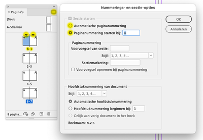

February 23, 2025
If you're typically trying to stick the back page to the left of the front page, then select that last (left) page, go to the side menu of the Pages panel and look for Numbering and Sections Options. Set the page to intentionally start with that last (even) page number. You can see the little triangle appaearing above it, just like with its right page next to it. The page will behave like a left page now, and won't push the existing right page away. However, this right page automatically gets this last page number +1, so you have to tweak that numbering option as well, to explicitly restart with 1 (and the others will follow). You'll end up getting two pages with triangles at the top.
Keep in mind that InDesign is not a printer's tool, but 'reader-inclined'. So all page layout approaches and features work at their best when you mimic what the user sees and uses to navigate (with regards to pages and columns), and not what a printer might find useful and efficient. Eventually, you're always in charge and can always tweak things to let the PDF reflect how the printer needs the pages to be ordered, but that's not InDesign's #1 priority.
But InDesign does hold on to any proper regional way of counting pages...
