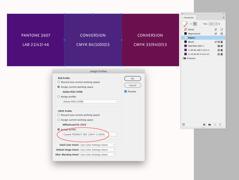

The client seems to want to design their own materials in coreldraw so I have advised about the colour conversion
Just make sure they understand that 2607 is out-of -gamut and can’t be reproduced via standard process CMYK offset inks. The appearance of  CMYK 84|100|0|3 would depend on the press conditions (the press profile), and InDesign will display it differently depending on the document’s assigned CMYK profile:

Offset printing on an uncoated sheet:

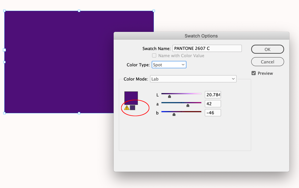

Sep 29, 2024 Sep 29, 2024
It looks quite off....
Also, PANTONE 2607 C is well outside the gamut of any typical CMYK profile, so you’ll never get a match with offset printing.
