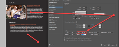

I can't figure out why a text border (left border) style I created doesn't wrap around an object. The border is just ignored and appears under the object frame. See samples.
Border style (top)
The border is ignored when adding a wrapped frame.

In “ParagraphBorder” tab, use “Text”.

It's not a bug … Just a wrong use of this InDesign feature: use "Text" and not "Column" [simplistic case]!
New Here ,
Oct 12, 2022 Oct 12, 2022
@FRIdNGE you are a legend! I don't think this option and what it does even exist in Adobe's help files. Thanks hips.

Image for the future readers of this thread:
