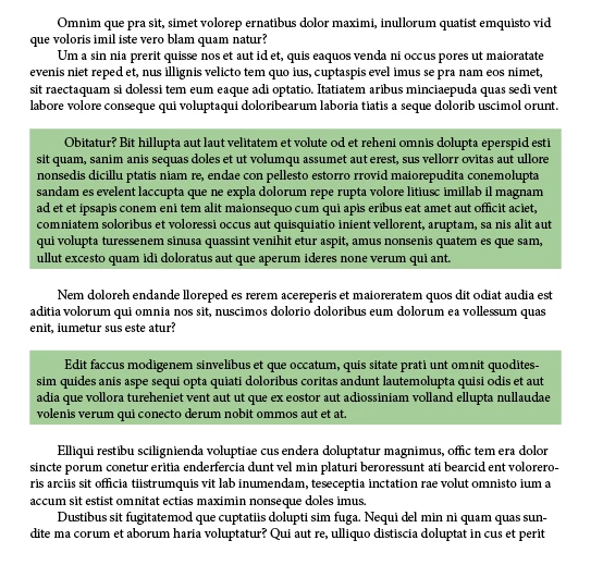

Hi All,
Is it possible to add a rule above or below my selected paragraph in the documents through Javascript?
In my document I require rule to cover whole paragraph (paragraph lines varies in the document) in selected paragraph style sheet named QUOTE.
See example below:
Please provide the JS code.
