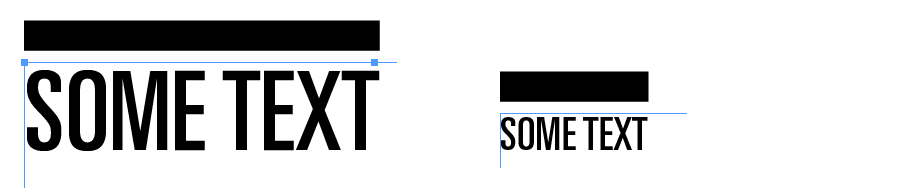

36 & 15 point text:
I would think you might also want the rule to be variable depending on the point size. That could be scripted as a percentage of the point size.

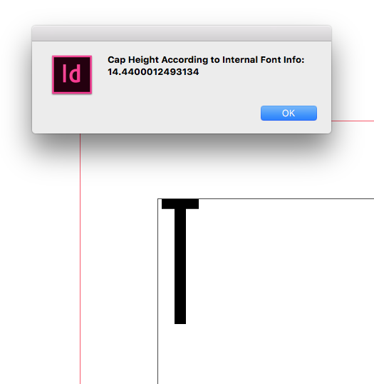

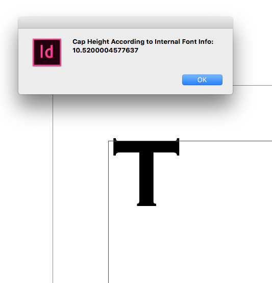

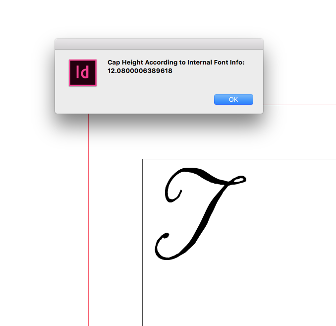

Thanks Uwe, that’s a very clever way to measure cap height!
But I'm guessing font variability would still get in the way of a feature that changes how the offset is calculated. Here’s 20 pt Copperplate, where the cap height and the x-height are almost the same, and Voluta Script, where the cap height is exaggerated relative to the total point size.
And Universe
