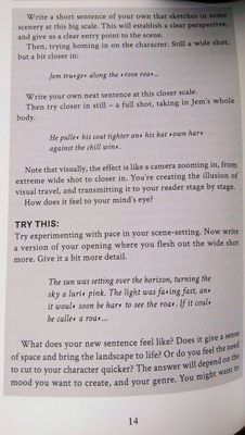

I've received a print copy now. The letter 'd' italic is wrong throughout the book, both within grey-styled paras and not.
This is not visible in the printer proofs PDFs. Can anyone advise how this might occur, please?
Jules
