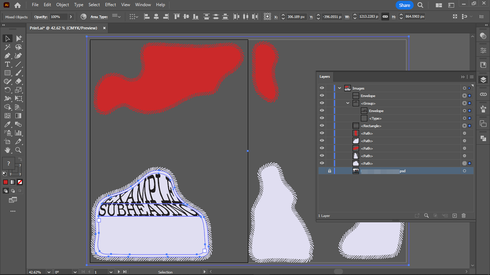

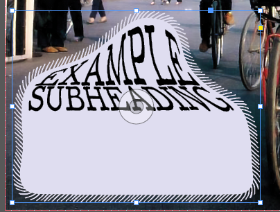

Enthusiast ,
Dec 12, 2022 Dec 12, 2022
This is what I export as AI, look at the frames:
And this is what I get when placed in InDesign:
This above is what I get when placed in InDesign.
My body text frame is number 3 from the top before the AI export, but I only get 1 rectangualr frame in InDesign.
I copied and pasted the selection into a new Ai file, and I placed that into InDesign.
